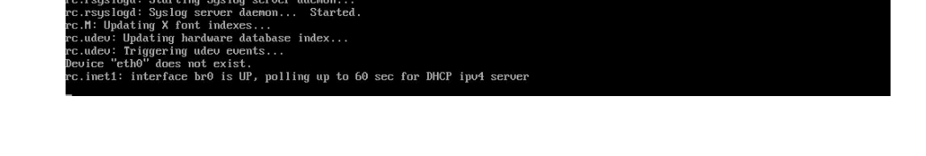

I did see during boot up:
And I still cannot disable or remove this ETH0, so I have to leave it there otherwise I get no network.

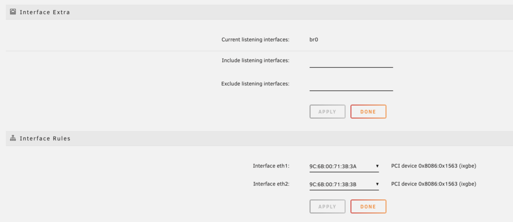

Not sure why, but this is the second case I've seen where the NIC is renamed from eth0 to eth1 during boot:
Jan  3 09:22:23 namek kernel: ixgbe 0000:42:00.0 eth1: renamed from eth0

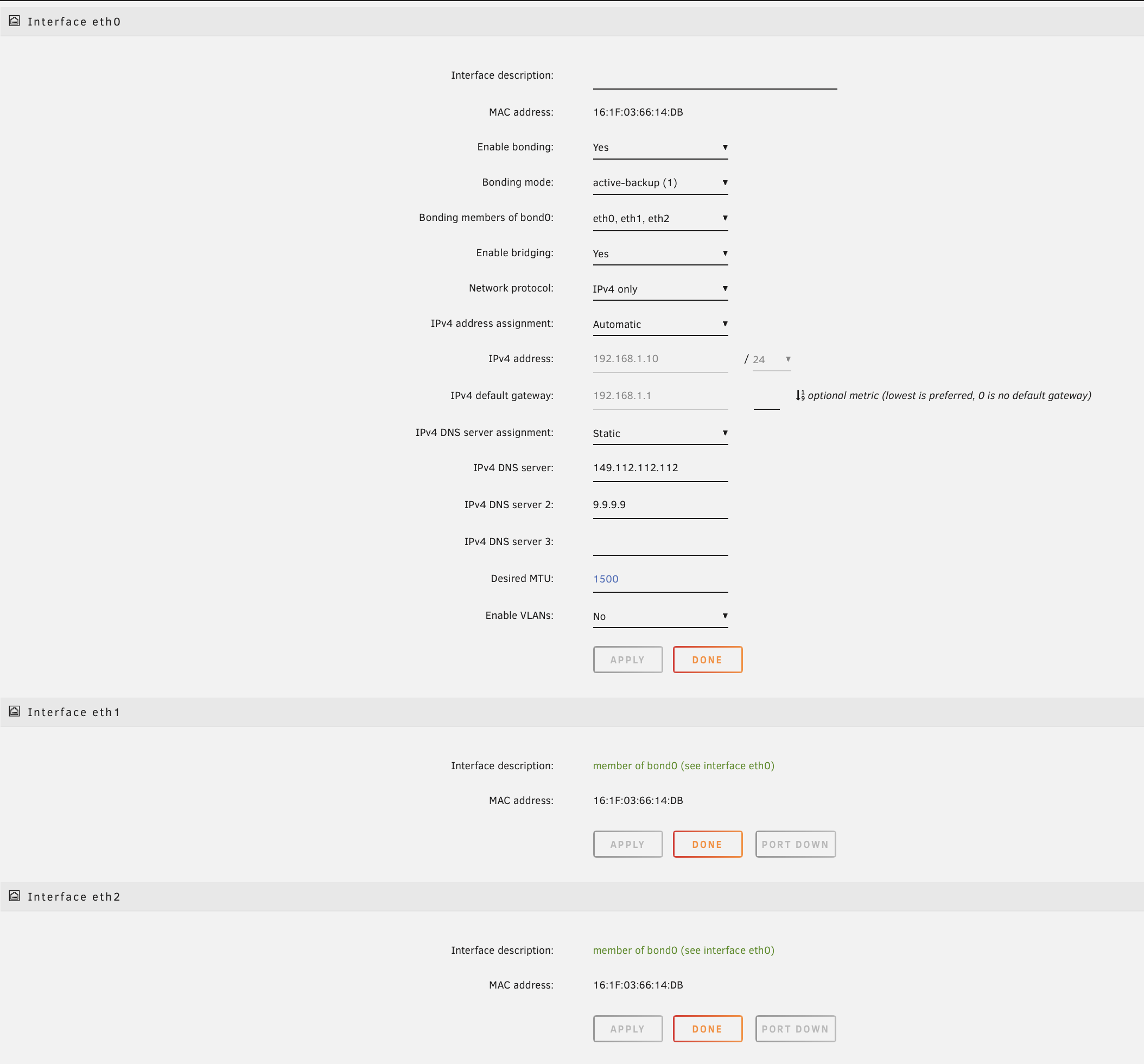

The solution for now is to use a bond with eth1 or eth2

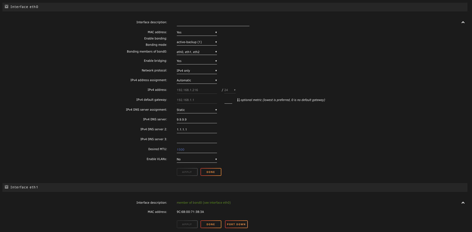

Yeah I've left it as a Bond as per the image above.
If I disable that I lose everything.
