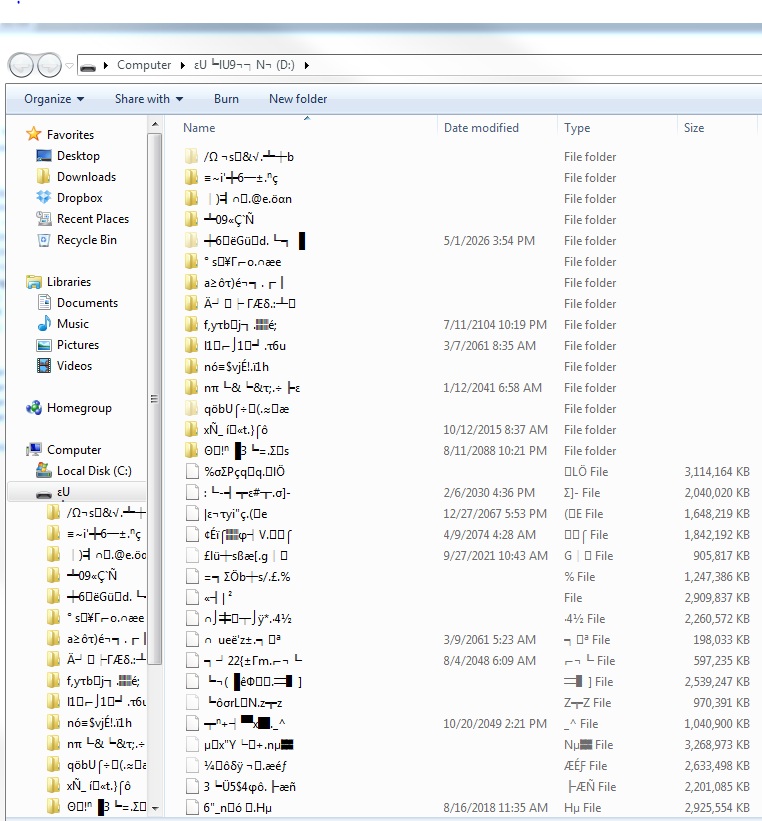

While navigating around, I clicked on the //tower/flash share in Windows Explorer, and saw a mess of garbled file and folder names. Thinking this was strange, I connected via PuTTY and saw the same thing in /boot. I then went to unMENU's user scripts menu and saw that my user scripts were all accounted for. Next, I went to the edit config files screen and it appeared that the scripts and .cfg files were all present and accounted for.
At this point, I made my mistake: I assumed that since I could see the various scripts and configs in unMENU and the array was working just fine, a simple reboot would fix whatever was going on with  the /flash share. Not so.
After shutting down and installing the new drive, nothing came back up. I also noticed that the light on the flash drive was not flickering like it usually does during boot. I shut everything back down, plugged the flash into my Win7 PC, and saw the attached.
So, it looks like my flash drive it toast. It's really strange because, as I said, I've hardly had to touch the thing since building it 4 months ago, and there has been no recent power outages or anything else like that.

as long as you assign your parity drive correctly, what slots the others drives are in will not make a difference.
I use the dropbox addon and once a week - save a copy of my flash to the dropbox folder as i have had one flash drive die already (was a used one, current is brand new).
You have probably not lost any data on your drives, so all is not lost :)
Good luck
Myk
Thanks. I ended up going out and buying two identical flash drives, and I'm setting them up now.
Obviously when I assign the drives to parity/disk, I'll be sure to use the exact same setup as before. The only part I'm concerned about is re-setting-up the user shares so that they exactly match the old configuration. Is there any risk if I don't get this exactly right once I start the array?
Also, I'll amend my previous statement: this experience hasn't turned me off buying a license for a device GUID. Obviously it's not unRAID's fault that my (5-month-old!) flash drive crapped out. It has taught me to back up the entire flash drive, and when I am ready to buy a license, get the two-pack.
-Rick
EDIT: I started it up, and the system automatically detected my old shares. That was an unexpected surprise. I still need to redo the share settings, but the fact that they were all detected saves me some work.
