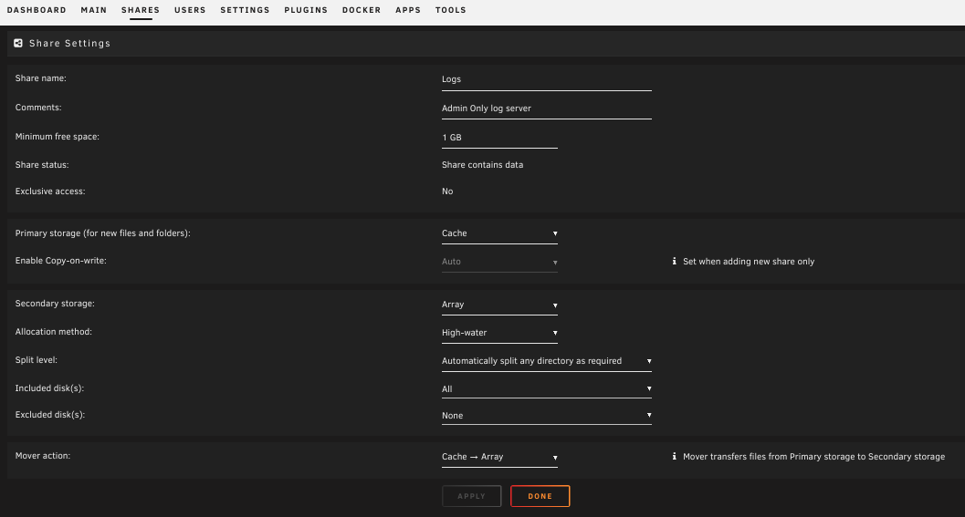

Now, I have a Logs directory set to cache -> disk that I use as the log server storage location for other network devices, but it seems that pointing the unraid syslog at that directory is killing me here. I don't want to pile logs onto the Flash, so what's the best way to handle this issue?
