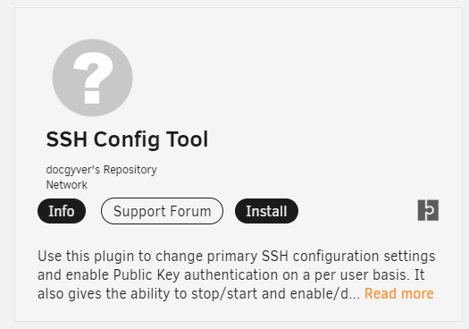

CA install ssh plugin. aditional users in unraid are more for samba not ssh.
with thsi plugin you can turn the users  into ssh users. you may need to manul eidt you ssh config both at /etc/ssh/sshd and at /boot/config/ssh

This plugin has not aged well and doubt it will be updated and make a proper defautl secure sshd config.

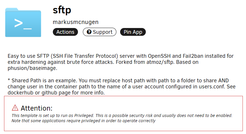

I'd have you look at sftp docekr in ca:

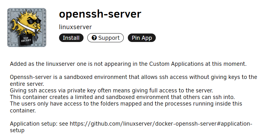

or use the linux server openssh server docker:
to restict host access.
It was not updated since 2021 ... seems it is not maintained more.
