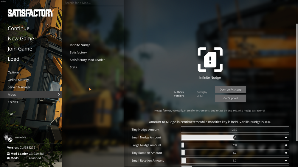

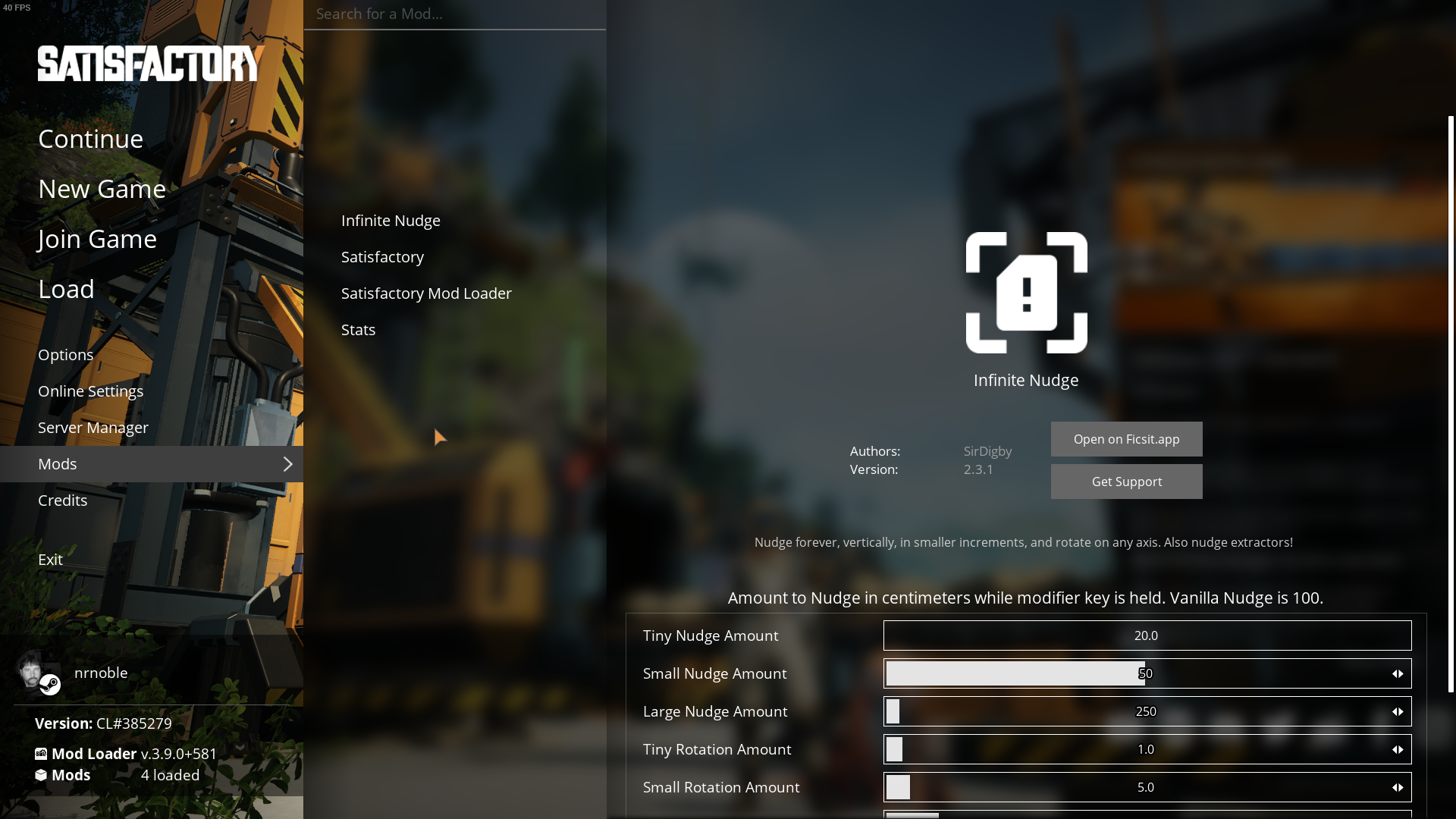

  4. Thanks, I will continue to investigate. It is odd that one mod works, but all others do not. According to what I read so far, there should be a Mods directory somewhere on the game server, but I cannot find it. I can't even find the one mod that does work. Overall no big deal. Already completed the game twice without mods.

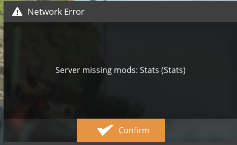

  5. I have installed ich777's Satisfactory Server and it works perfectly. I have only been able to install one mod "Infinite Nudge" and it works fine. It was the first mod I installed. SMM appears to down and install the mods (no errors while using SMM). When I attempt to join the server, I get this error message "Server missing Mods" for all other mods other than Infinite Nudge. When I disable the mods that will not load, I can join the server and play, otherwise I am blocked. Using SFTP, SMM connects to the server and appears to install mods (no errors are displayed) Any ideas as to what I can try or where I can find related error logs?
