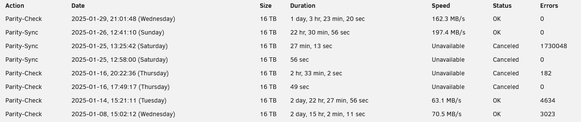

Fixed:
Memory test showed no problems. Ran a correcting parity, then ran a parity check and had even more errors after a day. Then started to run another and had 182 after a couple hours so stopped and bought an LSI 9211-8i.
Not only has my speed drastically increased (nearly maxing out the HDDs at 250MB/s each) but my errors are down to 0 for now.
Partiy check seems to slow to about 150MB/s in the last 10% which is interesting but still way faster than before. 1 day instead of 3 is a big improvement. The big error check was one of the disks not being picked up when I first installed the new card but reseating all the cables fixed that.
