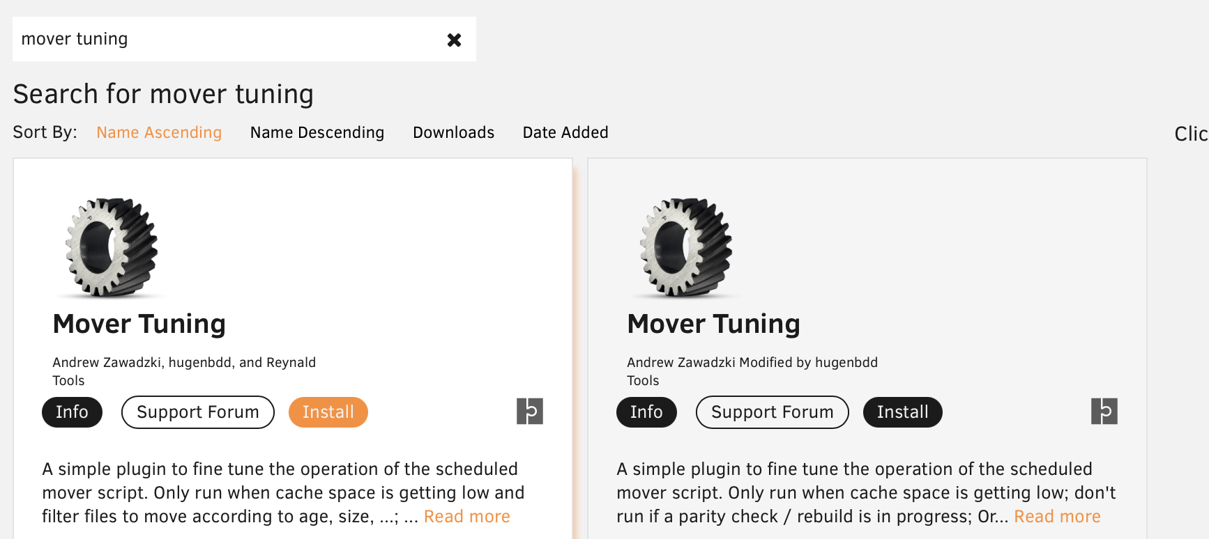

On 1/19/2025 at 1:59 PM, Robert Annetta said:
Thank you!   Figured out what was going on.  Appears there are two Mover Tuning plugins.  The one I had installed hasn't been updated in over a year, the other one mentioned being updated to support 7.0 in September.  Uninstalled the one and installed the one with a newer release day.  Instantly resolved mover issues.
Hope this helps other running into an issue with Mover.  Might be worth figuring out who maintains the Fix Common Problems to detect the version that hasn't been updated in over a year and highlight the use of the other one.  The other version was always up to date, because there wasn't a newer version than the 2023 version for that one.
 Which plugin should I use?
There are 3 listed
The above 2 and
Mover Tuning
Andrew Zawadzki, hugenbdd, Reynald and masterwishx
Rod
Thank you!  This solved my issue as well.  I was on the old Mover Tuning... there are actually now three different versions that show up in CA.  Uninstalled the old one and was immediately able to fire Mover up again.   I have about 2TB worth of moves to run, but afterwards I'll re-install the newest container release and see if Mover still works after that.
