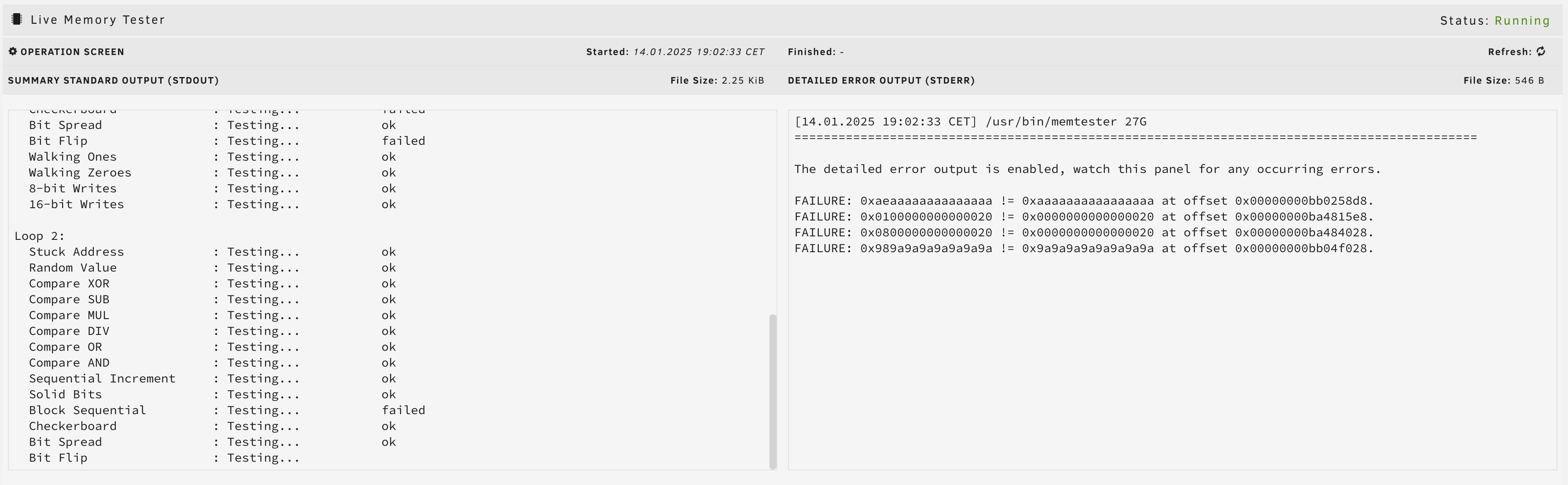

OK I started a new test until now the following errors occur:
Does this mean the memory is damaged or can it also be a software issue?
Sorry for probably stupid questions, but I don't have any experience with these kind of problems
I'm not very familiar with the live memory tester, but if I were to use it I would start my array in maintenance mode before running it, or better yet run the memtest provided in the unraid boot menu on startup.
If you do in fact have errors on your ram then it's more than likely a bad stick of ram or a little less likely a bad ram slot on your motherboard, or if you're lucky maybe you just need to re-seat your ram.
I strongly suspect that if the Live Memory tester finds errors you really do have them.   In theory it could by an error in the testing software but I think that is unlikely as others would be encountering it so we would have a lot of reports of false positives.
This.
