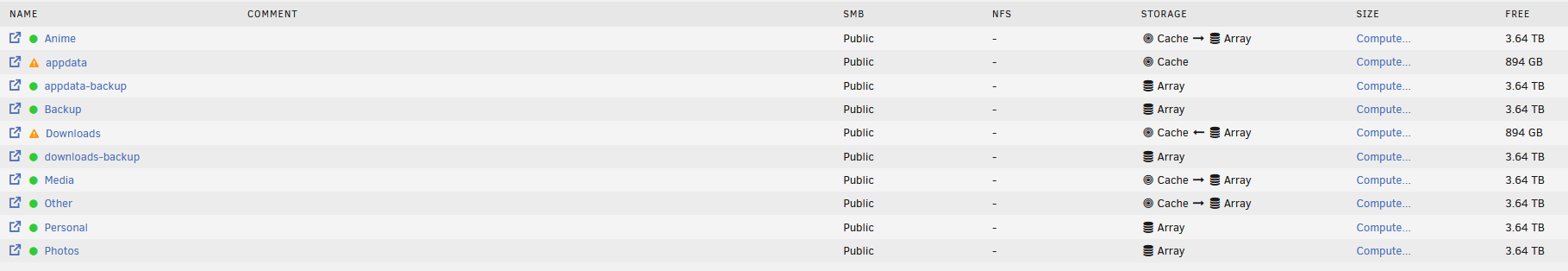

So I'm not sure what I've configured wrong. I have a /Downloads share (cache only) and a /Media share (Cache enabled). But copying a completed file from /Downloads -> /Media takes forever. Like sometimes 20-30 minutes. So if I download something I want to watch right away it takes a tediously long time to become available in Plex.
I don't understand why the process is so slow, because both locations should exist on the same SSD cache drive. Should be writing from /Downloads ssd location -> /Media ssd location and then the mover moving it into the main array nightly. But it's so slow.
I want the move from the download location to it's final media location (ignoring if it's in cache or main array) to be faster so it shows up in Plex sooner.

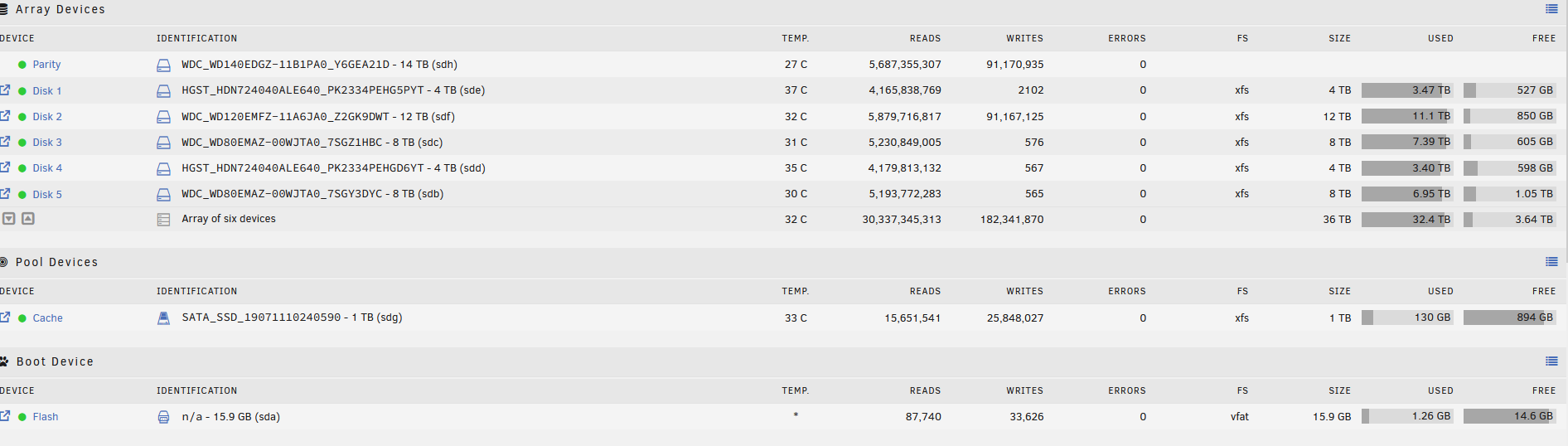

Current build is:
Xeon E3-1225
Supermicro X10SL7-F
20 GB DDR3 ECC
Quaddro 2200
1 TB Sata SSD
36 TB array (14 TB Parity, 12 TB, 2x 8 TB, 2x 4 TB)
Proposed new build (repurposing old gaming machine, marked with *)
*i7-9700k
*MSI MPG Z390 GAMING PLUS ATX
LSI 9400-16i HBA card
*32 GB DDR4
*Quaddro 2200
2x 1 TB NVMe for appdata/cache pool mirrored (ZFS?)
Reuse existing 1 TB sata SSD for download cache?
Purchase much larger parity drive (tired of keep having to upgrade it). 24 TB? 26 TB?
Purchase some new high capacity data drives (2x 18 TBs?)
Reuse any >= 8 TB drives from existing system.
I also have a wide variety of small sata SSDs (500 GB or less) and older HDDs (4 TBs or less) if needed for anything, but I mostly assumed they weren't worth the space.

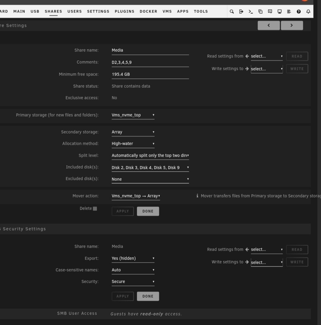

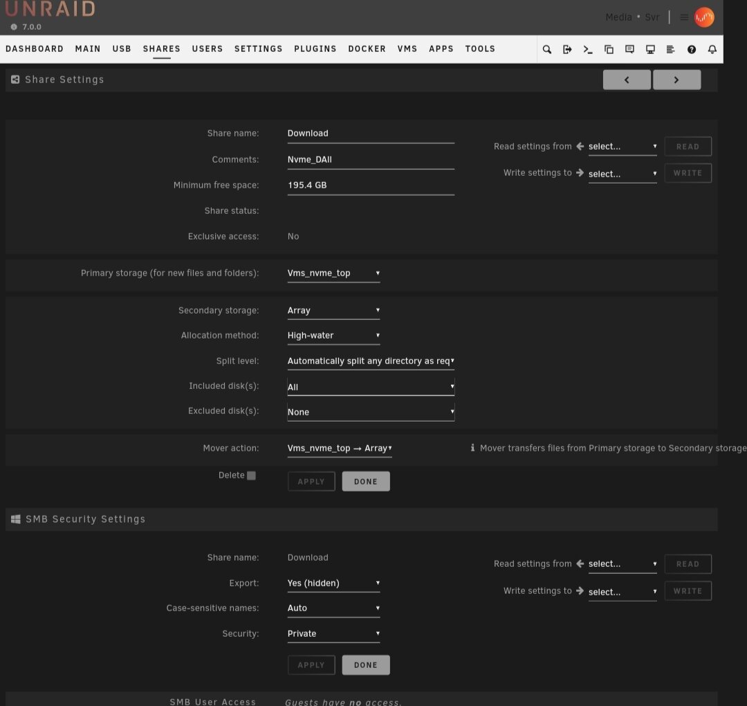

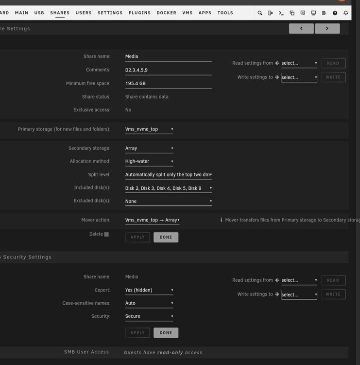

-I think you got your mover going backwards on the Downloads share; don't know if that's part of your loading problem.  The images here are my Media and Download share settings.  My nvme_top is a btrfs mirror and the array is all 18TB spinners with 1 parity.  I think you can get to where you want if you try and copy those settings.  Use the Download for both your Downloads and Unpacking drives.
IMG_20250113_171900.thumb.jpg.ec98050605bd81ba5b0b893befc787a9.jpgIMG_20250112_084846.thumb.jpg.dd1de3bd1e5ddf996a775669744ad9b5.jpg
Wow, can't believe I've had that backwards for like 7 years. Updated the mover and pinned the CPU in NZBGet to CPU 0, so hopefully that helps. Between this and a new system, I'm hopeful this is no longer an issue.
