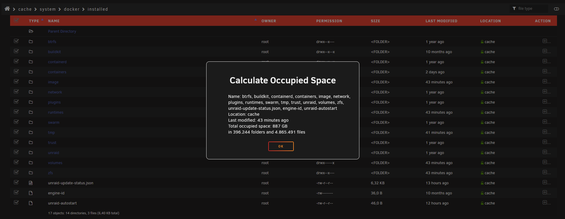

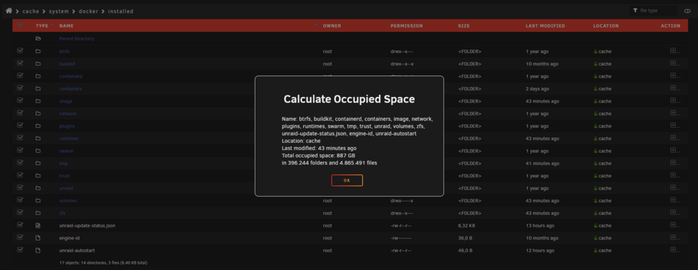

1 hour ago, trurl said:
appdata and system shares are on cache and set to use cache only, but it doesn't look like there is much if any data on cache.
There is already some data.
Update 1:
I can only explain the large amount of data by the fact that I had set up a container incorrectly at the time and the Docker cache files I configured were stored there. I have just been able to find them.
However, I have been using a revised version for a while now, which is set up properly and stores the data in the correct location.
I'm glad I noticed this. That's several hundred GiB of data that I can put to good use.
I have now deactivated Docker and had the Docker Instaled folder deleted by the settings. With several 100k data this still takes a few minutes.
