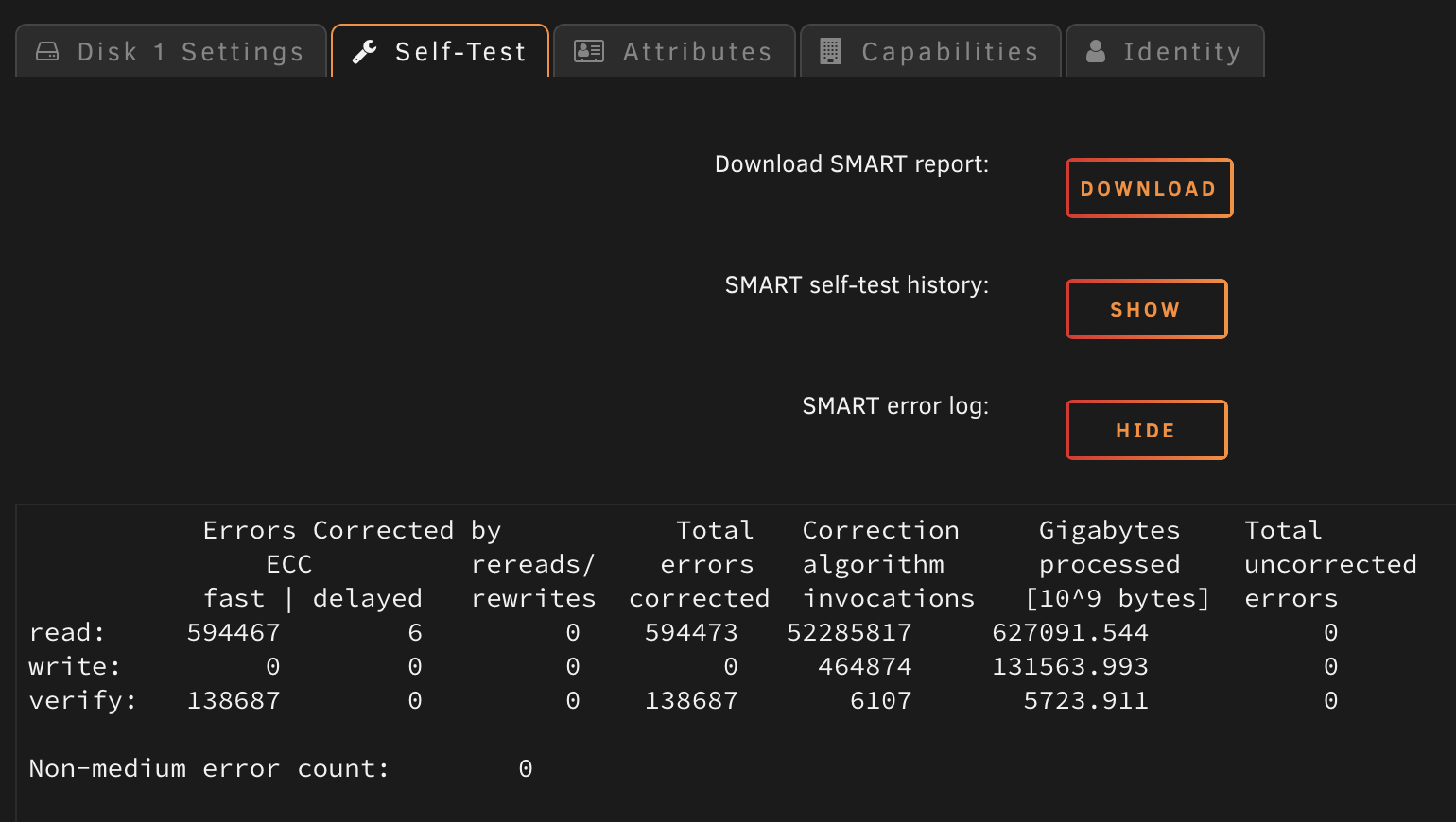

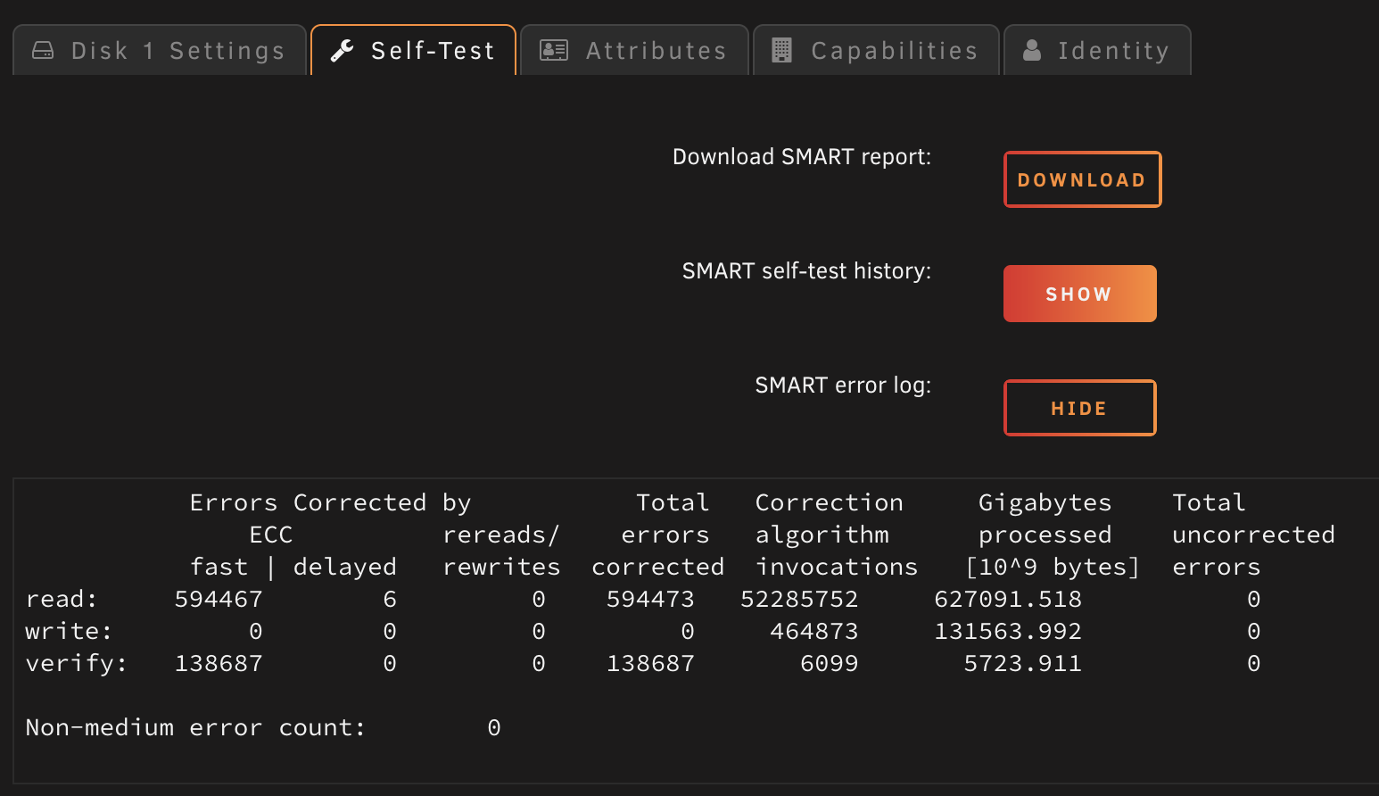

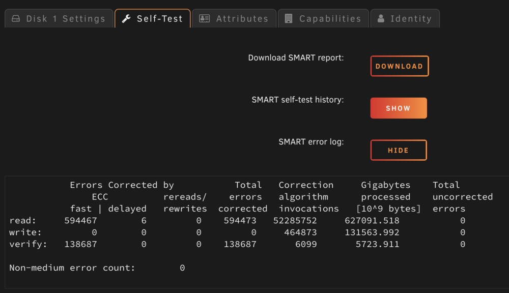

I did find two disk with some "issues" see attached images and replaced them I also reconnected all the power and SATA connectors to the drives and to the board but no dice.

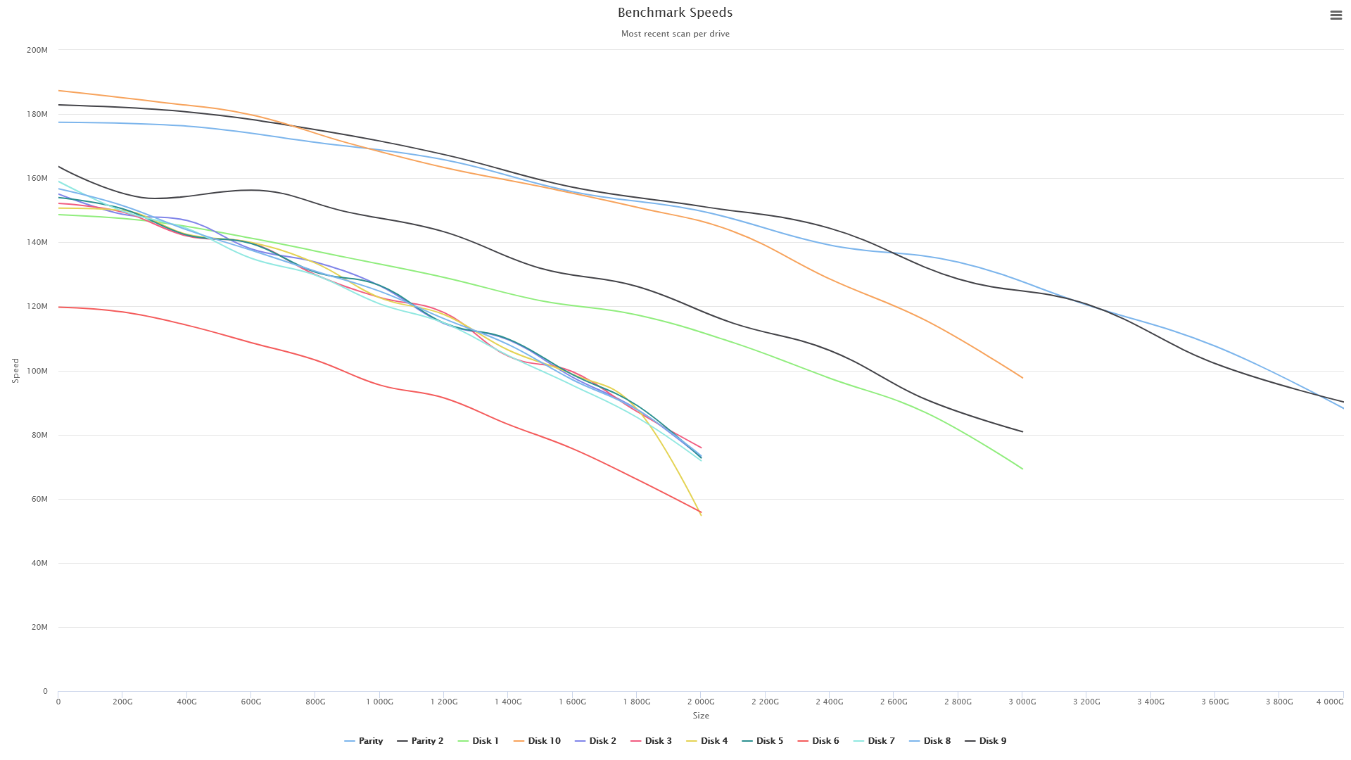

I did run the DiskSpeed docker and the results are attached.
Disk 6 seems to be on the slow side but even that is between 119Mb/sec and 56 Mb/sec.
