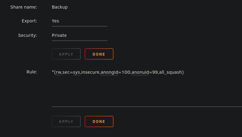

Hello for NFS you can add rule
For example mine is:
*(rw,sec=sys,insecure,anongid=100,anonuid=99,all_squash)
The line automatically added to my /etc/exports become:
"/mnt/user/Backup" -fsid=106,async,no_subtree_check *(rw,sec=sys,insecure,anongid=100,anonuid=99,all_squash)
See the rule part added.
So i guess for read only:
*(ro,sec=sys,insecure,anongid=100,anonuid=99,all_squash)
Doing that the /etc/exports isn't updated or erased after changes.
Be careful because activating NFS on share makes impossible to make "exclusive access" on this SHARE.
Edited by waazaa
