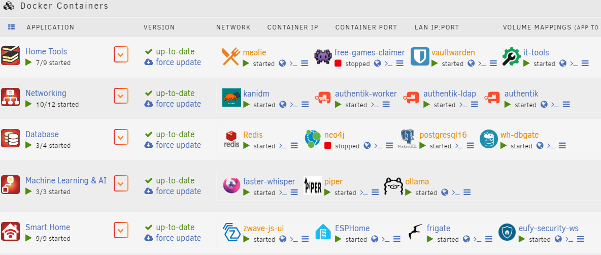

1. After a fresh setup (clearing Docker folder and redownloading all containers), everything works normally for a bit (I'm not sure when it starts to break)
2. After a couple of hours I notice some containers become "not available" (orange highlight in UI), despite definitely being available on dockerhub or github
3. Once this happens, I can't update ANY containers (even available ones) and receive the following error:
Pulling image: esphome/esphome:latest [Various layer downloads...]
Error: failed to register layer: open /var/lib/docker/overlay2/c9d51d50aaab263982141b1cdadc2f28757be5c6be53001702e0d92f705e4bac/link: no such file or directory
