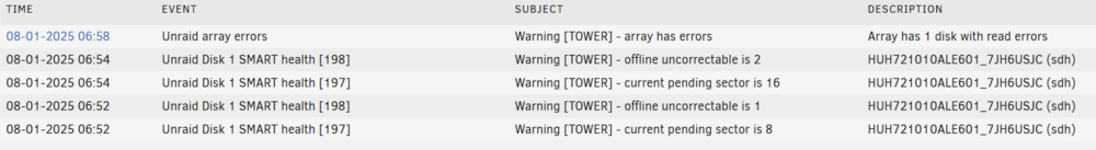

I saw this basic subject line in another post. They posted smart test results and diagnostics. I have the diagnostics (below), but when I try to run a smart test (short) the button just toggles stop/start and does not perform a test. Does that mean I have a dead drive? Thanks for any help. Also, here's a screenshot of warnings.

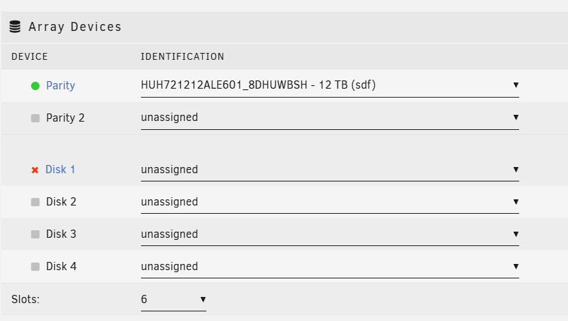

Post a screenshot of Main - Array Devices

OK, let's see if parity emulation will allow disabled/missing disk1 to be mounted.
Don't assign anything as disk1 yet. Just start the array in normal (not maintenance) mode and post new diagnostics.
OK, emulated disk1 is mounted and has plenty of data.
Stop the array, assign new disk as disk1, start array to begin rebuild.
Array started. Data rebuild underway. Thanks for your help in this process so far.
