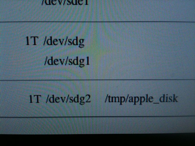

I tried it with sdg, sdg1, sdg2, and now after sdg2 in disk_manager it shows the /tmp/apple_disk after it.
That is encouraging.
