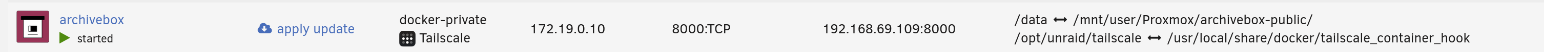

The container mappings for tailscale look normal:

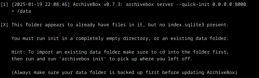

On a fresh install I get this:
ArchiveBox doesn't seem very happy when putting the state directory into the main folder, however disabling the integration, let the container start for the first time seems to have fixed it:

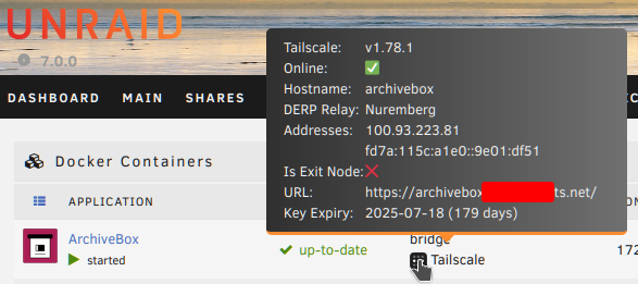

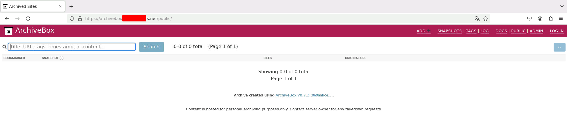

I can access Archivebox through my Tailnet as you can see above.

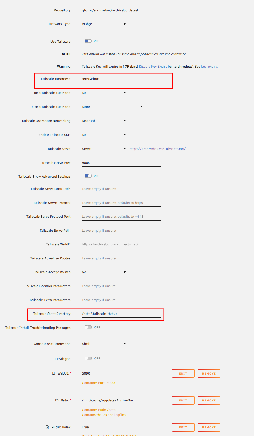

My configuration looks like this:

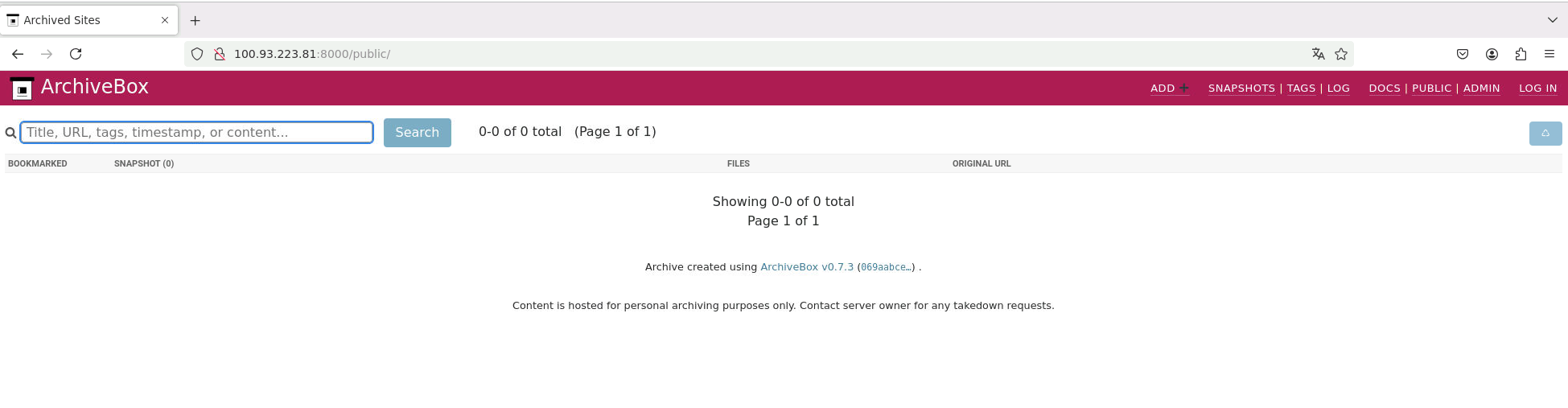

Connections through the Tailscale URL are also possible:
Could it be the case that your state dir is maybe messed up?
Please do the following:
  1. Stop the container
  2. Delete the .tailscale_state directory from your data directory from ArchiveBox
  3. Delete the already registered machine in your Tailnet
  4. Click on force update on the Docker page for ArchiveBox
  5. Start the container
  6. Open the logs and re authenticate via the Tailscale link in the logs
