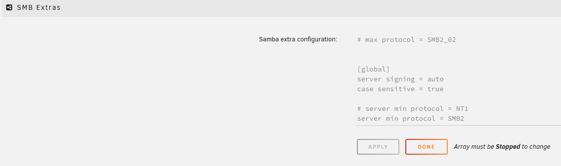

@JorgeB was referring to SETTINGS >>>  SMB and then down to this section:
(Some of mine  are old settings that are now a part of the standard SMB configuration. Probably should remove them someday but I am lazy...)
Yes, that's the first half of their statement, which is why I specifically asked for the changes I gave an example for. The second half of their statement referred to the UD plugin. But I can't find a "root share" option in its settings.
