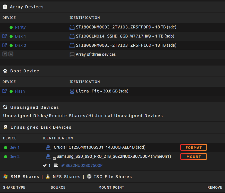

Hi I have made some kind of error trying to replace a 256GB SSD with a 2TB NVME Drive in my cache. I currently cannot mount my new 2TB drive and seem to have formatted my old 256GB drive and lost all its data.
I initially set up the system with an old failing 256GB SSD. This was a cache pool with 1 drive. I upgraded my server and added a 2TB NVME drive to the pool (along with some array drives which all are working ok). I decided I should remove the 256GB pool drive from the pool as it was failing and just go with a single 2TB drive. The pool was set up as raid0 so I assumed the same data was on each drive. I fumbled around trying to follow some advice on this forum but eventually stopped the array, removed the pool and created a new pool. Lo and behold when I created a new pool with the new 2TB drive, it created a pool with 2 slots, Cache was showing as "device missing" or something to that effect and Cache 2 showed my 2TB drive. This was not what I was expecting, I thought it would show just the 1 drive. All my docker data is gone, but some data on an SMB share is still accessible.
I have removed the pool again, and I notice I can't actually mount the 2TB drive. Below is the log:

Can someone please help me get the cache back up and running? I have Appdata Backup and restore on Unraid so I can at least partially restore my Docker apps if I can just get this mounted and working properly. I am quite desperate ☹️
Thanks
