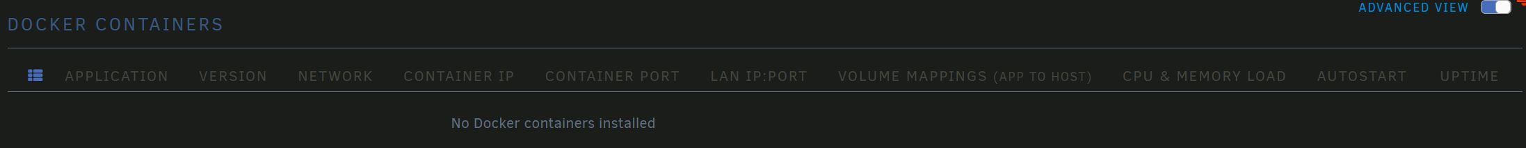

I've been trying to figure out why the VM manager and Docker tab states that I don't have any VMs or containers anymore. As far as I can see, the files are located as they should be:
I really hope someone can help. It should be mentioned that I tried to resize my Docker vdisk before installing the new version of Unraid. Since then, the VM manager and Docker tab state that I don't have any VMs or containers anymore, even though the files seem to be located correctly.

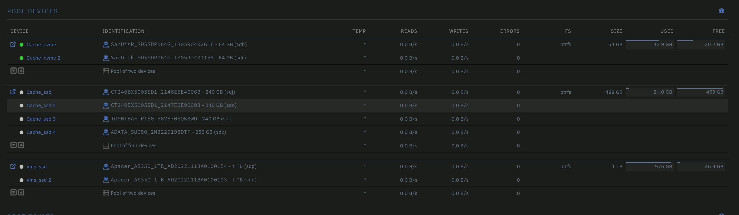

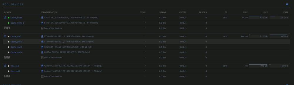

However, when I check all the pools, there seems to be space available? 🤔

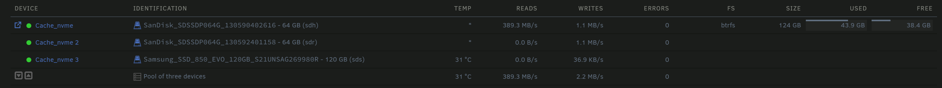

I've added another disk to my pool. Its seems like its doing some reclaiming / allocating / data moving, as the math doesn't add up if I look at Size = Used + Free
Appdata floor is set to 24GB, and the pool only had 20GB free.

It wasn't just empty, it was a new image, but you are not the first one this happened to after upgrading, so there may be some corner case issues, unfortunately, there are no the logs showing when it happened.
