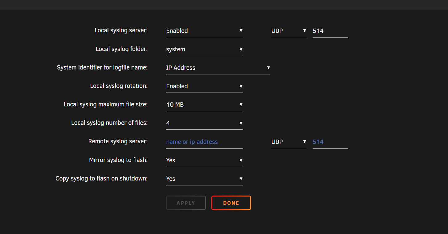

The syslog is already enabled and i show you in my previous comment that nothing appear.

The syslog you posted is the same syslog already in Diagnostics, so it doesn't show anything before last boot.
Setup syslog server
pretty sure that its already enabled, but cant check right now because I got another freeze ...
It should also mirror to my usb stick.

No, those are the same too.

You also have to set Remote syslog server to the IP of whichever syslog server you want it sent to, such as your Unraid IP. Then you should be able to access it at the path you specified (your system share).
The actual setup of syslog.

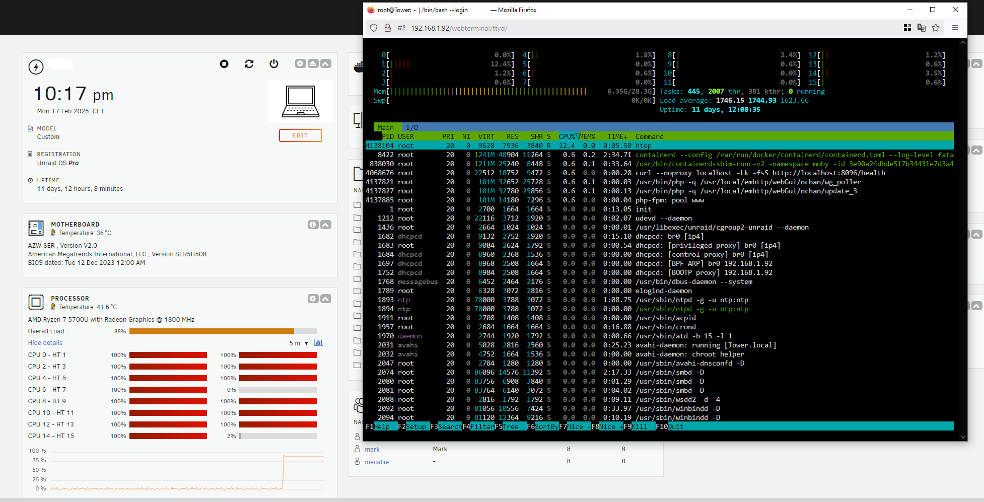

Alright, now my CPU went to almost 100% and stayed there. It did not completely freeze yet. And the weird part: I just turned off all my docker containers.
I could not see what process was using the CPU that much, see the screenshot. I did see this error in the logs:
Feb 17 21:36:15 Tower kernel: cgroup: fork rejected by pids controller in /docker/3e90a24dbde517b34431e7d3a42ff057e1583e34280f14cec81c2371ca3792c9
Feb 17 21:36:15 Tower kernel: traps: .NET TP Gate[838131] general protection fault ip:148510f6650f sp:1443dccd9e60 error:0 in libc.so.6[148510f66000+155000]
9 hours ago, Mark12 said:
fork rejected
This suggests an issue with one of the containers, and could be causing the high CPU.
