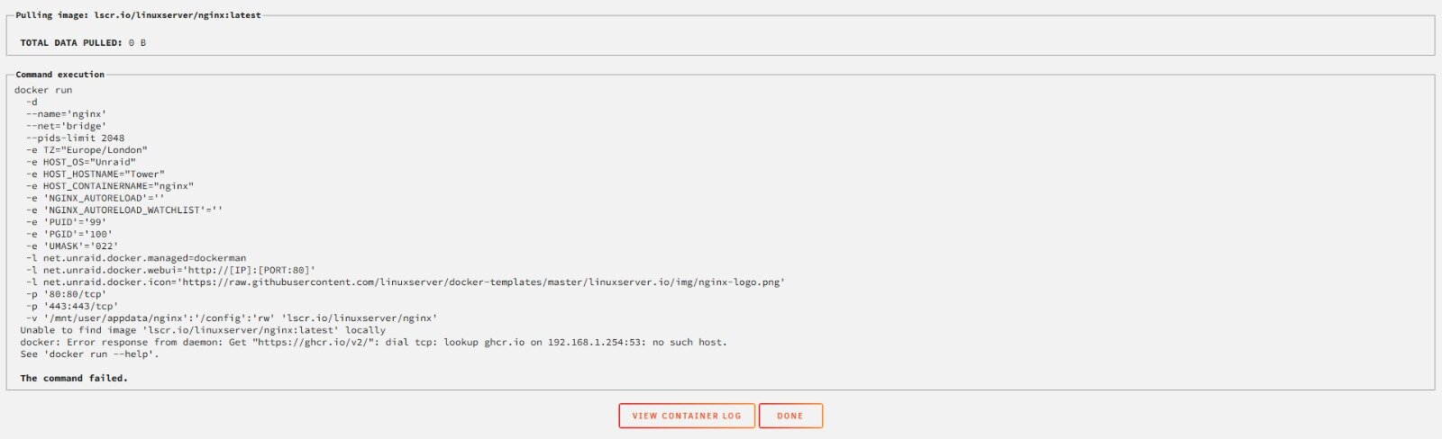

Hi guys, have also started having this problem recently after changing home and getting a new ISP and Router.
All my apps that are from ghcr.io or lscr.io repos are unable to download or update. All others work fine. Can someone point me to the right direction? I'm on unRAID 7.1.4.
