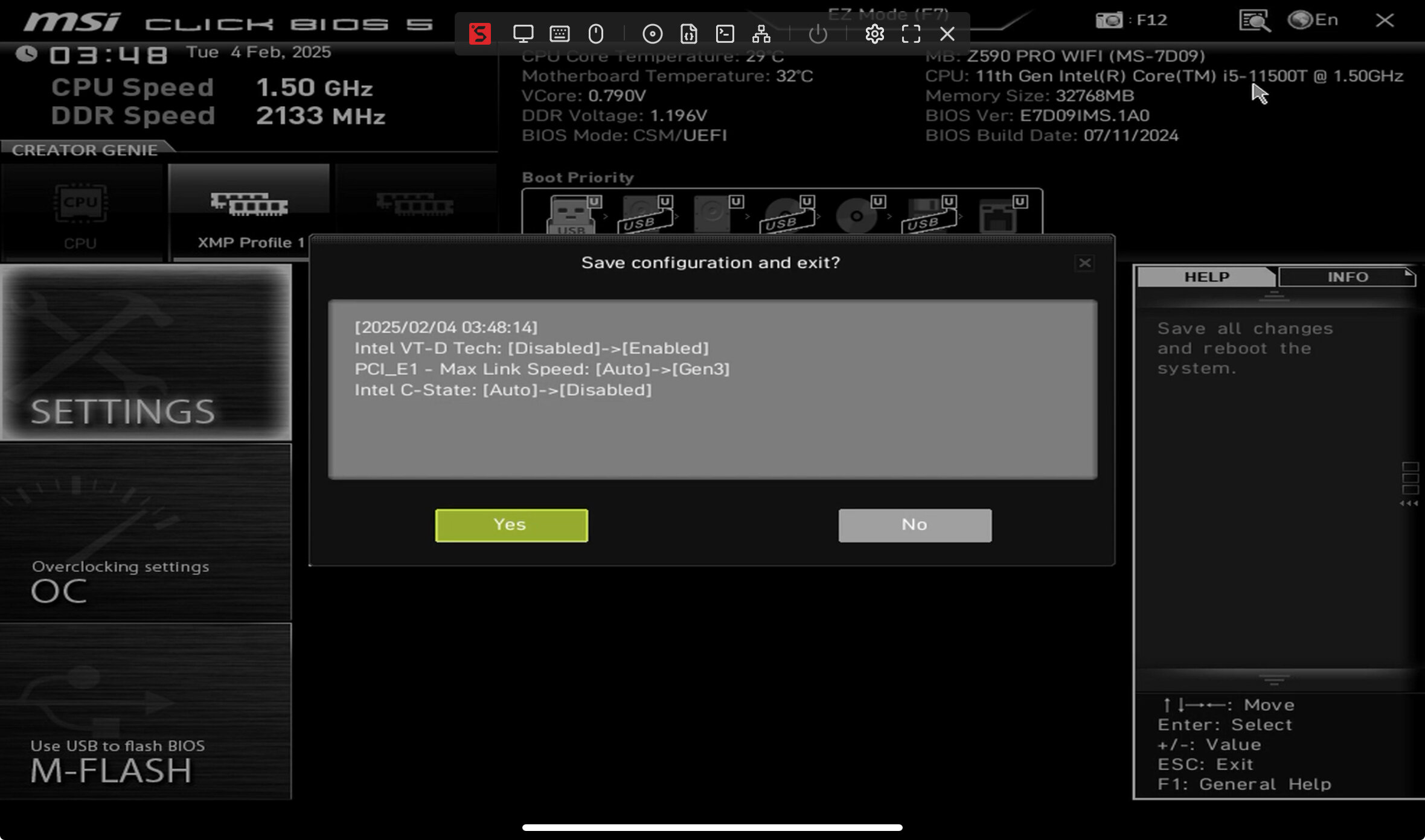

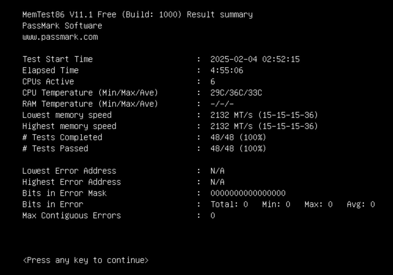

Thanks @JorgeB for providing some directions. I have ran latest version of memtest86 over night snd it shows all passed. I am suspecting it is s C-state problem, as the parity checks take around 26 hours to complete and it frozen 2-3days after restarting. This seems matching the timeline of frozen.
I have made the changes in BIOS as attached and see if it helps. If not, I will go with the route of running in safe mode.
May I know does it matter to have safe mode with or without GUI?
