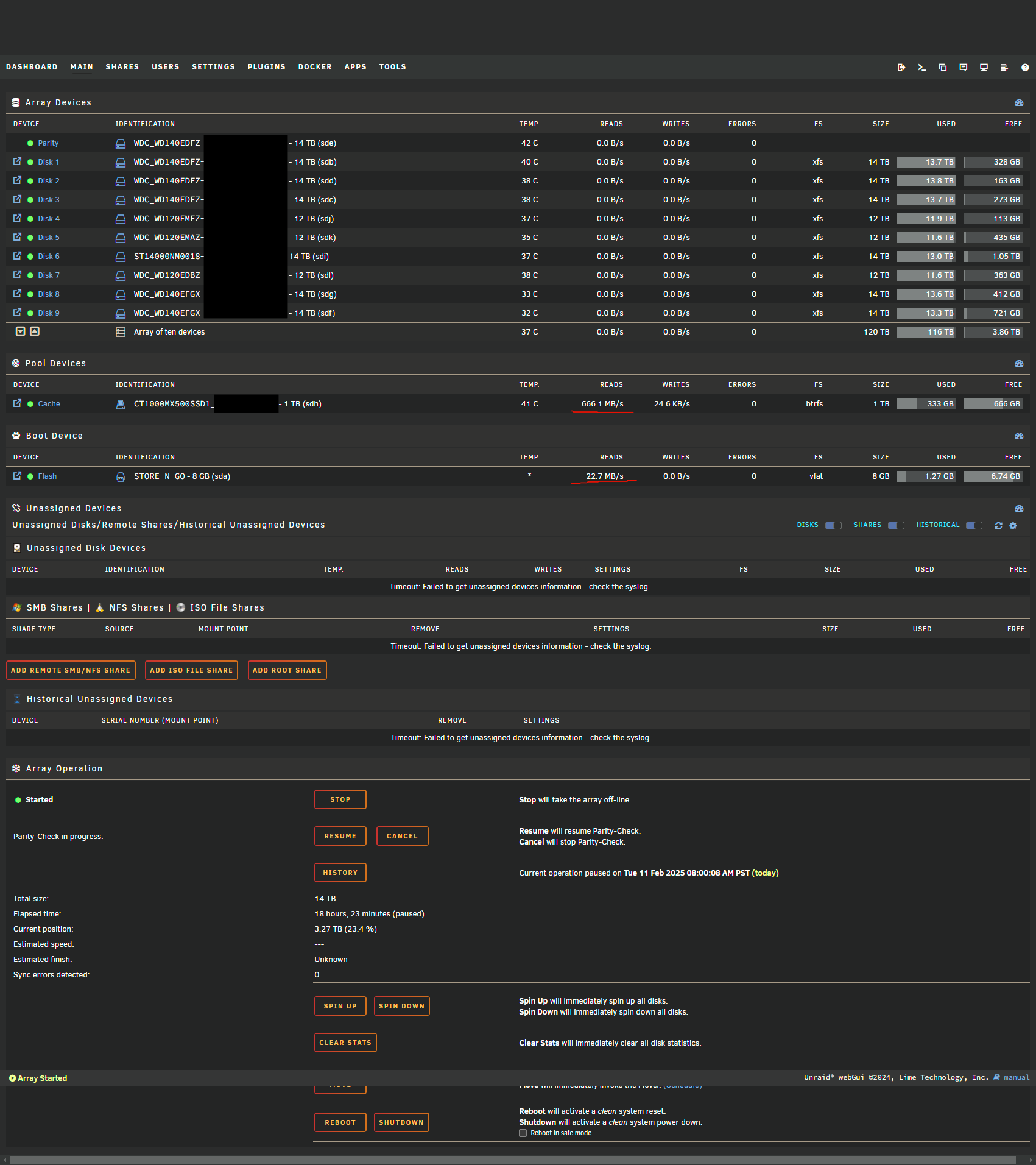

February 12, 20251 yr Author Update: After rebuilding the docker image with the previous containers restored, server seems much more stable! I had 6 days of uptime. Yesterday I mounted an external hard drive with Unassigned Disk Devices, and it was dismounted on its own shortly after. I was unable remount after multiple tries, and today I found my server very slow - almost unresponsive at 6pm. I am getting the similar out of memory error, and php-fpm error. There is a high read in cache drive and some read on flash, I cannot confirm processes is consuming the 100% CPU usage. Feb 11 18:13:53 unRAID php-fpm[9253]: [WARNING] [pool www] child 32653 exited on signal 9 (SIGKILL) after 427.466938 seconds from start Feb 11 18:13:55 unRAID php-fpm[9253]: [WARNING] [pool www] child 2861 exited on signal 9 (SIGKILL) after 287.056577 seconds from start Feb 11 18:14:07 unRAID php-fpm[9253]: [WARNING] [pool www] child 10615 exited on signal 9 (SIGKILL) after 13.046237 seconds from start Feb 11 18:14:08 unRAID php-fpm[9253]: [WARNING] [pool www] child 10694 exited on signal 9 (SIGKILL) after 12.878893 seconds from start Feb 11 18:14:21 unRAID php-fpm[9253]: [WARNING] [pool www] child 11005 exited on signal 9 (SIGKILL) after 13.019033 seconds from start Feb 11 18:14:22 unRAID php-fpm[9253]: [WARNING] [pool www] child 11073 exited on signal 9 (SIGKILL) after 13.837164 seconds from start Please see the attached diagnostics and screenshot. Will provide an update when if it becomes unresponsive again. unraid-diagnostics-20250211-1828.zip
February 12, 20251 yr Community Expert Update to v7.0 and try this, but this happening suggests you are getting close to exhausting the server's RAM: https://docs.unraid.net/unraid-os/release-notes/7.0.0/#excessive-flash-drive-activity-slows-the-system-down

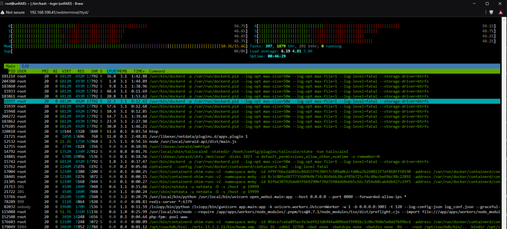

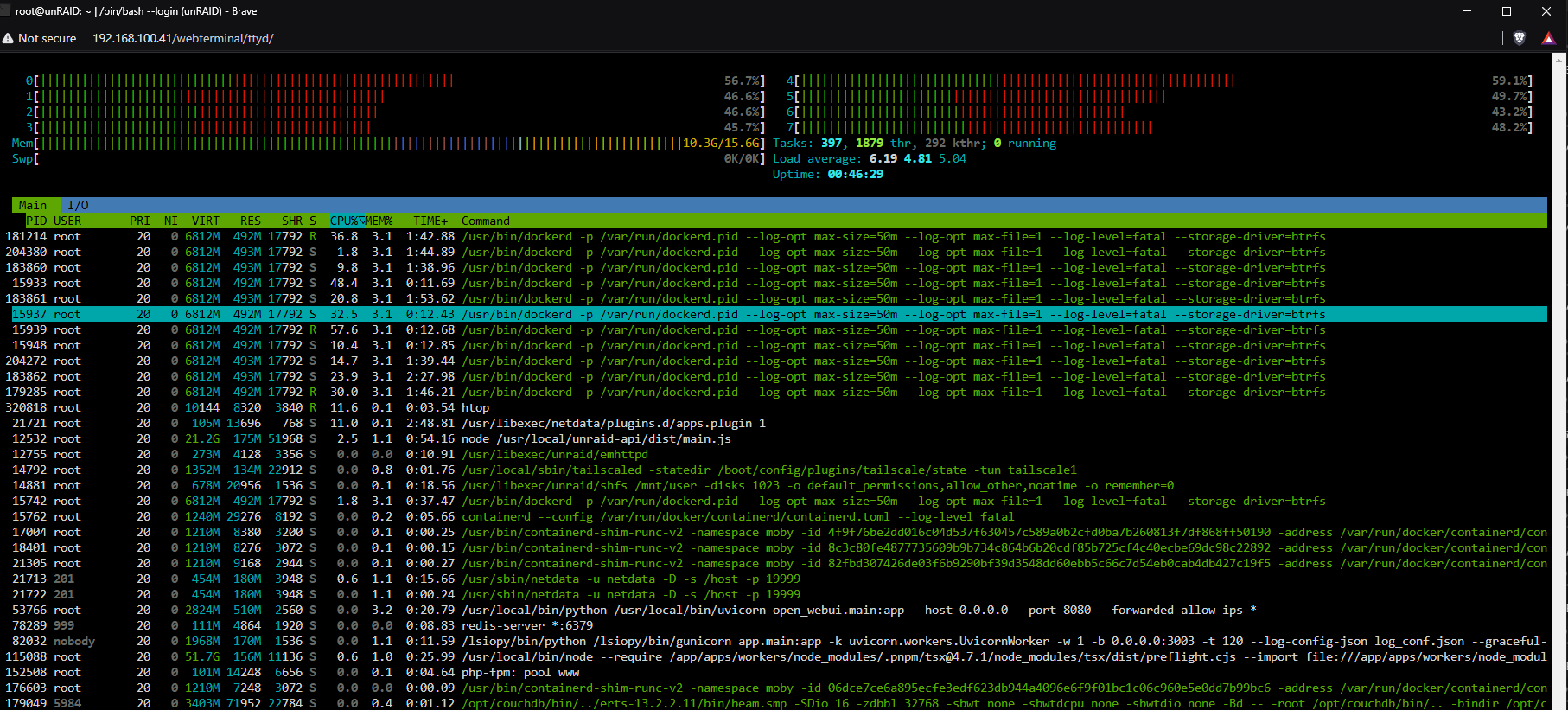

February 19, 20251 yr Author After rebooting, my CPU is hovering at 45% but I am unable to see any container using the resource through Netdata. This is what I see in the terminal with "htop" command. Should I be concerned about the repeated "docker run --log-opt max-size=50m --log-opt max-file=1 --log-level=fatal --storage-driver=btrfs my-container"? Thanks.
