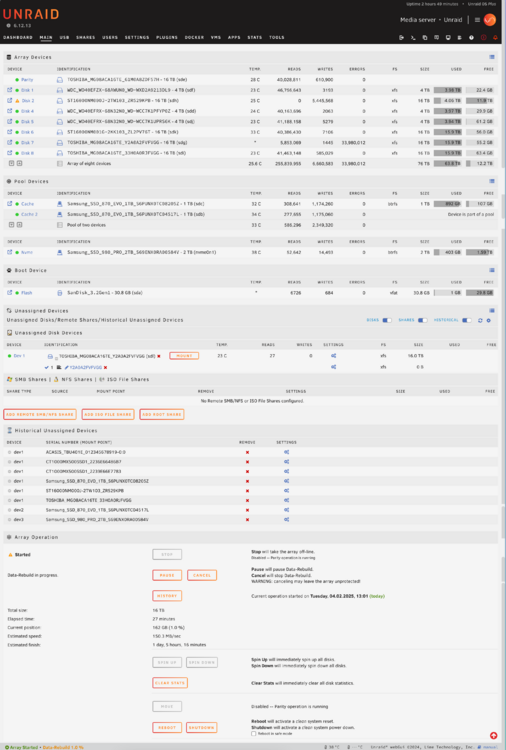

  • System was getting fulll (already had a larger disk ordered)
  • Unraid became unresponsive yesterday. I thought it had just filled up.
  • So I shut it down, replaced a smaller 4tb disk with a new 16tb disk and bootet up (disk 2)
  • Apart from the missing 4tb disk another of my 16tb disks showed as unavailable (disk 7 sdg in the picture)
  • Powered down, checked cables and bootet back up again. Disk now showed, but as unmountable
  • I formatted the new 16tb and started the array. the rebuild started
  • Apparently it rebuilds the 16tb and not the old 4tb? As that one receives a ton of errors but the fresh empty disk no activity at all
  • The old 16tb that is now being rebuild also shows up as an unassigned disk?!
So questions:
- Should I let the rebuild finish? it is halfway through
- Why does one of the other disks all of a sudden see so many errors during rebuilding? (disk 6)
- Basically: How can I get my system back to how it was and just have unraid rebuild the old 4tb onto the fresh 16tb?
Attached a screenshot and fresh diagnostics.
Thanks for any help! I am not a pro here, so help in layman terms would be really appreciated....

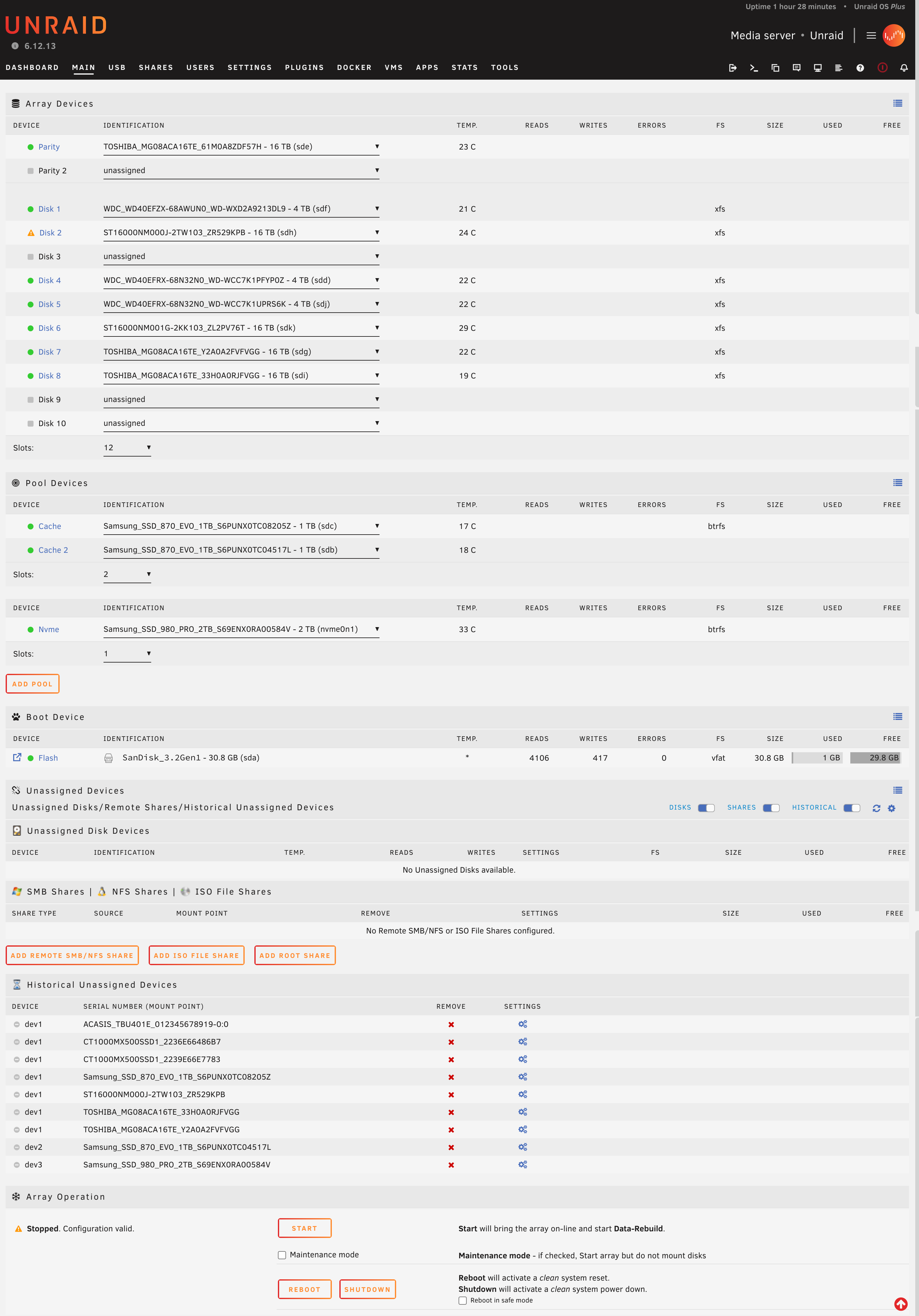

There are errors in multiple disks, reboot and post new diags before array start.
Should I reboot during rebuild or wait for it to finish?
No point in continuing the current rebuild with all the errors.
At least in stopped state the old 16tb is now recognized without issue and not shown as unmountable anymore.
This view is what I had expected originally. What options apart from just starting the array do I now have?
Edited by DTFagus88

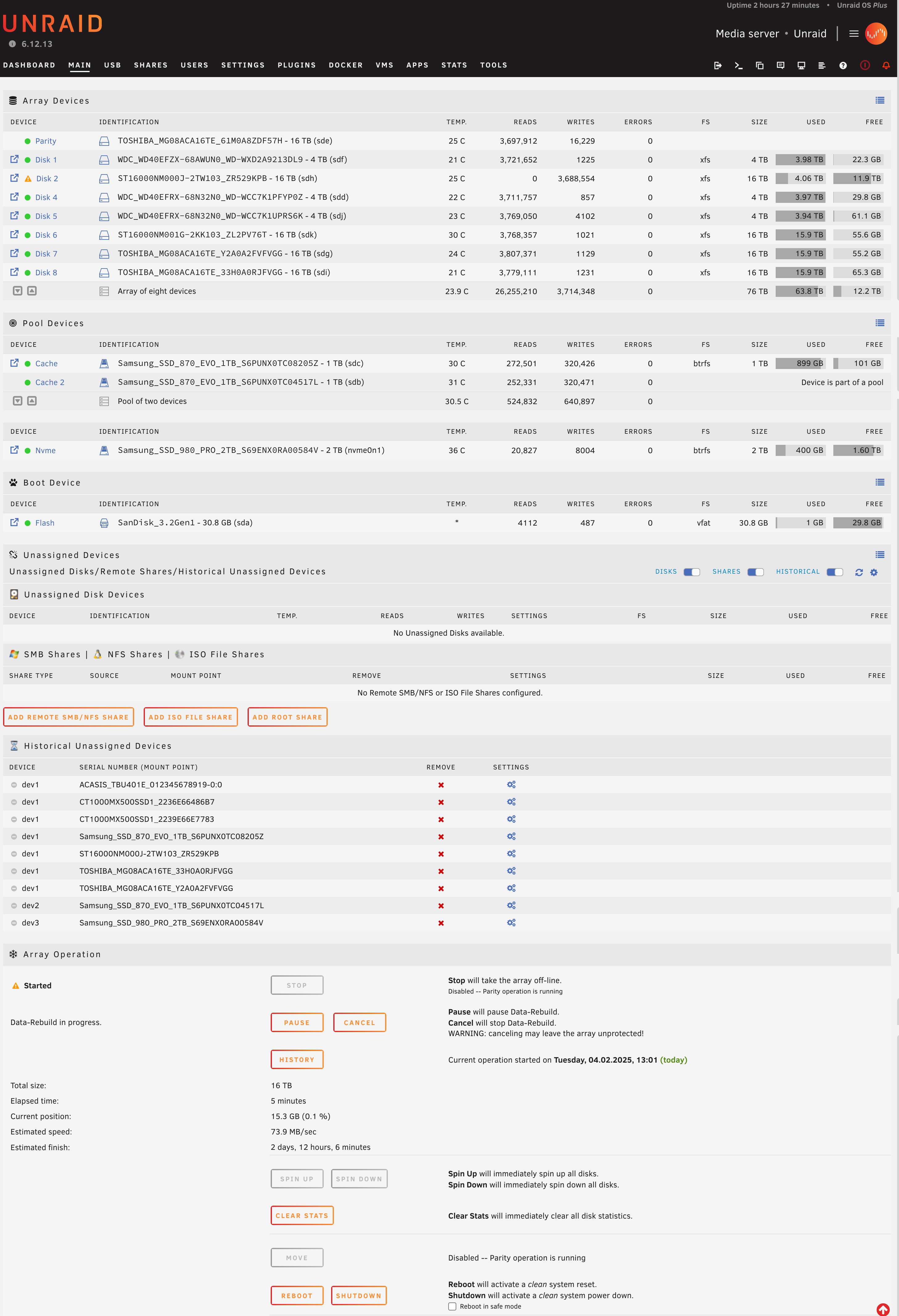

Start the array, wait a couple of minutes, and post new diags.
Here you go.
Now it looks like what I had originally expected (and all good?).
Do the diagnostics confirm that?
Was this just a glitch or would you recommend to change something? (like 2nd parity or replacing a particular disk?)
unraid-diagnostics-20250204-1306.zip

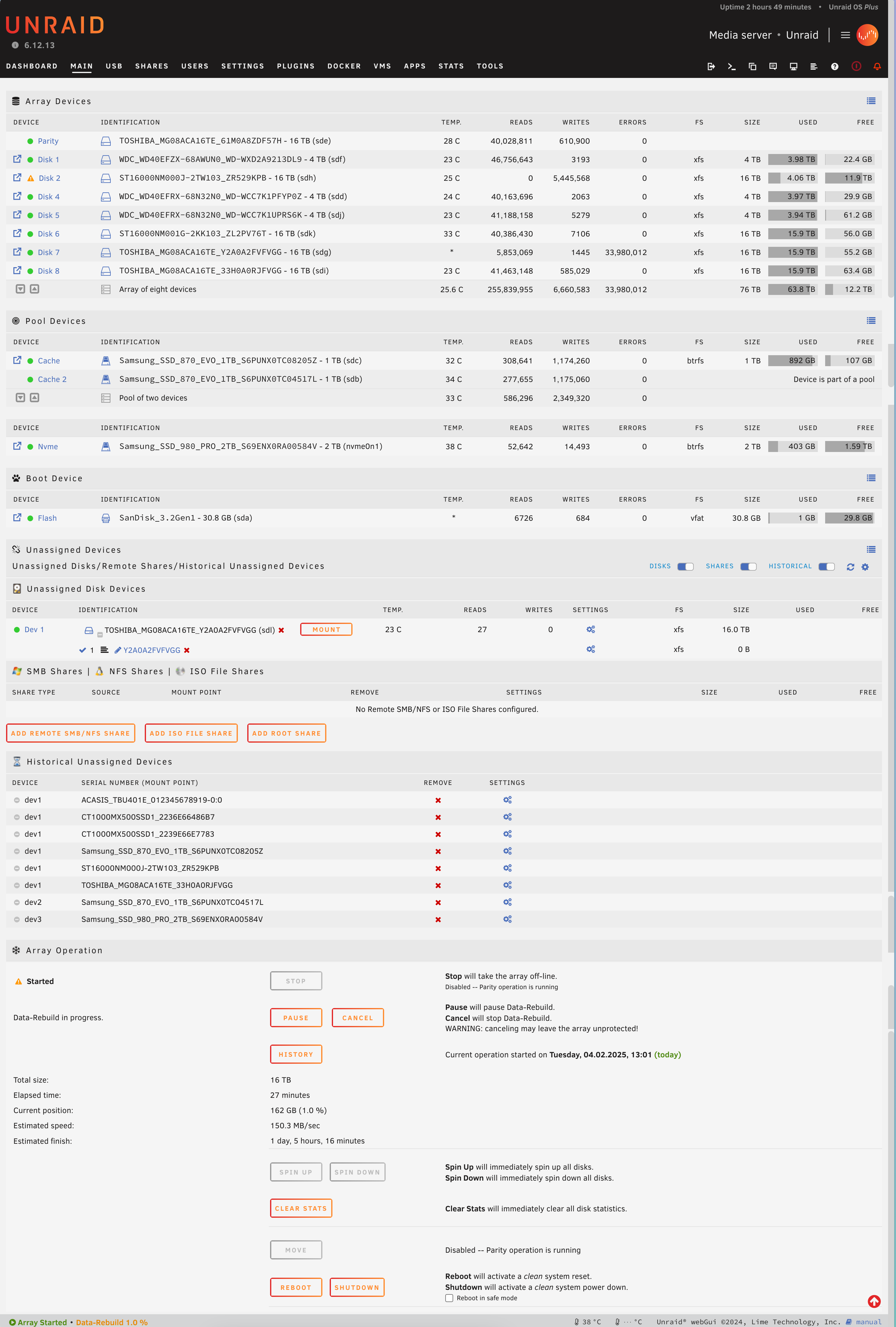

Disk7 had dropped offline before:
Feb  3 17:33:53 Unraid emhttpd: error: hotplug_devices, 1709: No such file or directory (2): tagged device TOSHIBA_MG08ACA16TE_Y2A0A2FVFVGG was (sdg) is now (sdl)
If it happens again, you should check/replace the cables.
Syslog is also showing some issues with the flash drive, so you may want to re-format, or replace it.

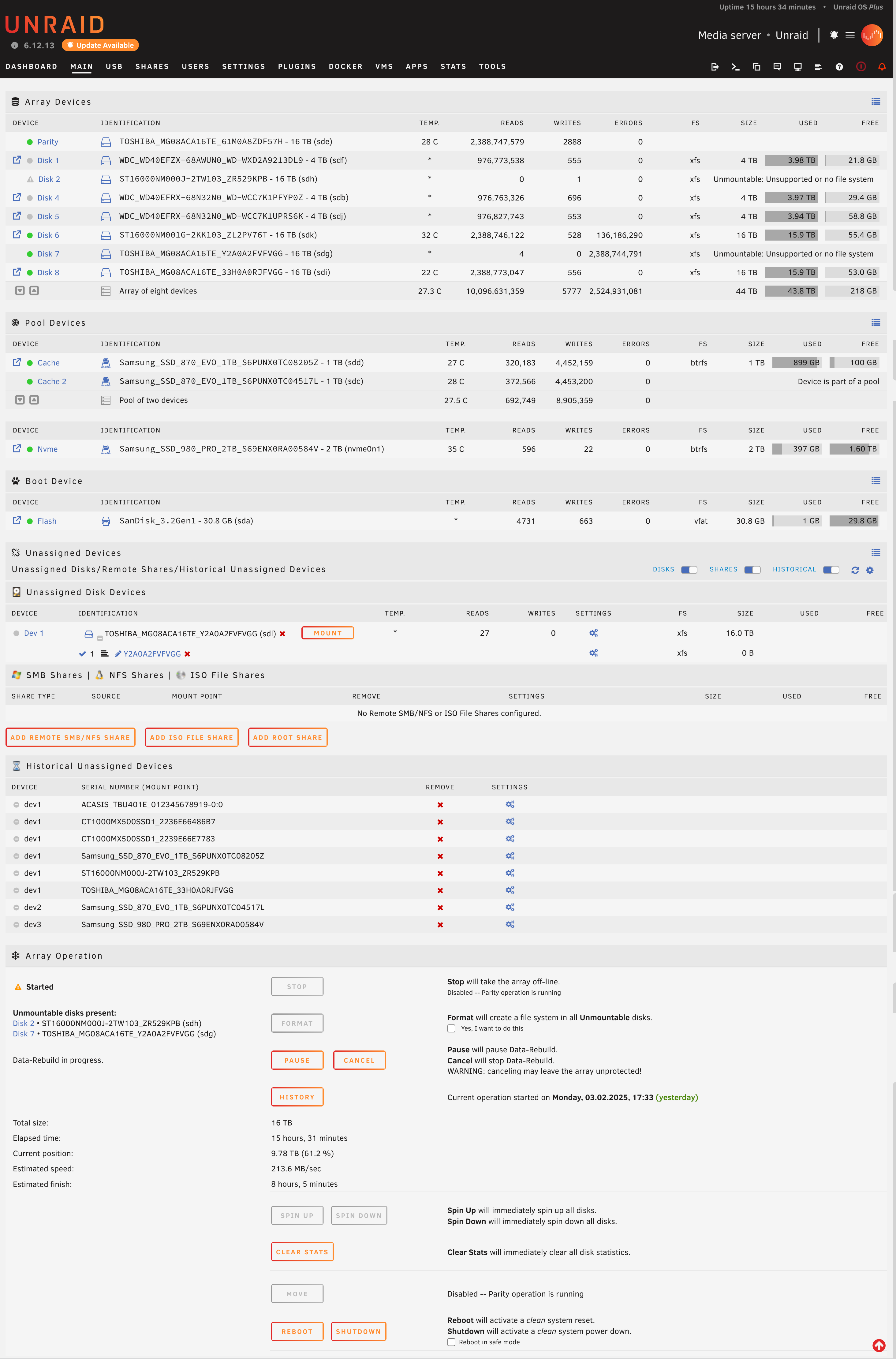

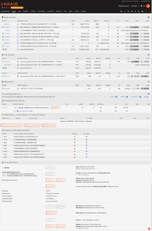

I spoke too soon :/
disk 7 starting showing up again in unassigned drives (and also in the array) and from that moment on that drive is showing errors.
Screenshot and diagnostics attached.
I'll power down and check cables again...
That drive is a year old and has been precleared 3 times... Would not really expect the drive itself to be faulty...
unraid-diagnostics-20250204-1329.zip
I do not really understand how the same device can be both in the array as sdg and also be an unassigned device as sdl.
That should not really be possible right?
