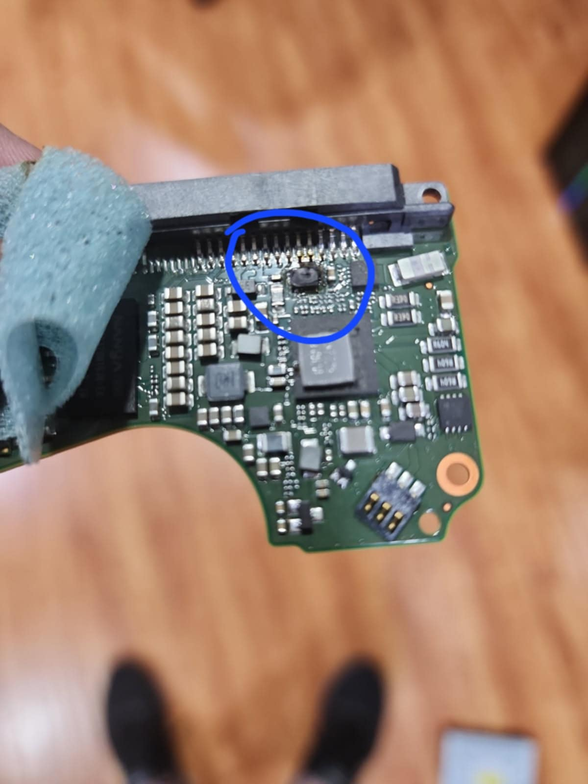

Well, things have gotten from bad to worse.
More and more drives went offline. The power supply (Gigabyte PM750GM) I was using seems to have killed the drives one by one. 6 Drives total. I checked the pcb boards one by one, one of them had a fried chip. Others didn't. Was being hopeful that others may still be functioning somehow. Got a BRAND NEW power supply, (Corsair RM850X), drives dead, 0 sign of life.
1000$ worth of drives dead.
Replacing boards is so tedious and way outside of my skills.
I think we can consider this matter closed. Thank you mods for the help.
Did you use the wrong cables on a modular PSU? They are not standardized pinouts.
