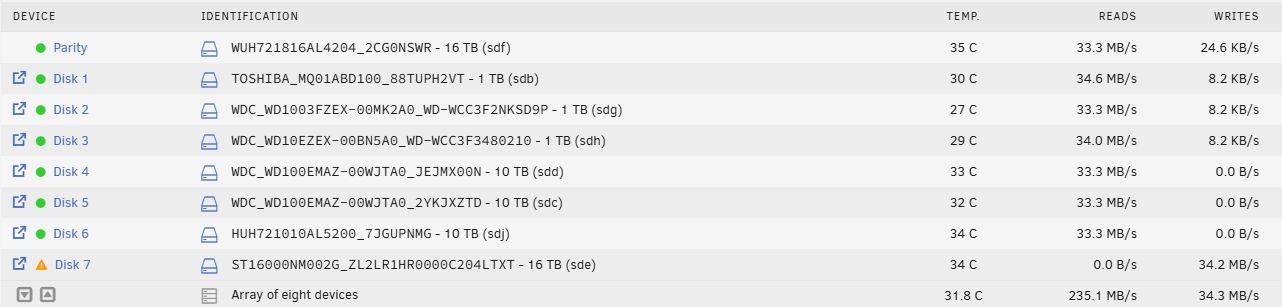

I've been having a rough time replacing a failing drive in my Unraid array, and now I can't even get a parity rebuild to start. Hoping someone here can help.
Background
I had a failing drive (Disk 7) that was giving read errors, so I precleared a replacement drive in advance. I had been having on and off problems with this drives, so I had also replaced my HBA and cables to isolate the issue. When I stopped the array, unassigned the bad drive, assigned the precleared replacement, and started the array, it immediately began throwing errors on the new drive. I did not remove the old drive, I simply unassigned it and assigned the new drive to the slot.
I then shut down the system, but ran into another issue:
  • I used the shutdown option in the UI, which showed "the system is powered down," and the display that the system was connected to was blank (not sure if it had been blank for a while since it's connected to my TV on a different input).
  • However, the fans were still spinning, and the system never fully shut off. I had to hold the power button to force it off.
Current Issue
After rebooting, I tried to start the parity rebuild, but Unraid no longer recognizes that it needs to rebuild anything.
  • When I assign the new drive to Disk 7, the UI does not say a parity rebuild will take place, just that the array will come online.
  • I tried temporarily assigning the old bad drive (original disk) back to see if it would recognize the need for a rebuild, but that resulted in an error saying it can’t start with a smaller drive.
I just want to get this parity rebuild going, but Unraid seems to have forgotten that it needed to do one. How can I force a rebuild at this point?

Thanks for the response :)
Here you go. Disk 7 is still in a disabled state, I suppose since it was throwing errors before I rebooted?
rashserver-diagnostics-20250206-0730.zip
Well, the rebuild went fine, then I started and stopped the array a couple of times for a different reason, and now the same disk is giving errors. Any thoughts? Diagnostics attached.
rashserver-diagnostics-20250207-2053.zip
