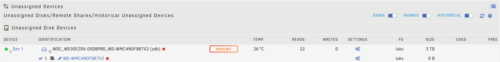

ok, I have plugged in the original (3TB) disk. It shows up in the unassigned devices.
Should I start the array (with the new 4TB disk) before posting the diagnostics?
Should I try to mount the original disk outside of the array?
I have started the array in maintenance mode (so that I can pass the encryption passphrase to unraid).
Then I pressed the [mount] button next to the original disk in unassigned devices.
Here is the log I see:
Feb  9 14:46:56 nedio-server unassigned.devices: Mounting partition 'sdb1' at mountpoint '/mnt/disks/WD-WMC4N0F887V2'...
Feb  9 14:46:56 nedio-server emhttpd: shcmd (4857): /usr/sbin/cryptsetup luksOpen '/dev/sdb1' 'WD-WMC4N0F887V2'
Feb  9 14:46:58 nedio-server nginx: 2025/02/09 14:46:58 [alert] 11265#11265: worker process 90202 exited on signal 6
Feb  9 14:46:58 nedio-server unassigned.devices: Mount cmd: /sbin/mount -t 'xfs' -o rw,relatime '/dev/mapper/WD-WMC4N0F887V2' '/mnt/disks/WD-WMC4N0F887V2'
Feb  9 14:46:58 nedio-server kernel: XFS (dm-8): Mounting V5 Filesystem f185aae9-b6c9-4eb8-b7dc-23ae79ee4411
Feb  9 14:46:58 nedio-server kernel: XFS (dm-8): Starting recovery (logdev: internal)
Feb  9 14:46:59 nedio-server kernel: XFS (dm-8): Ending recovery (logdev: internal)
Feb  9 14:47:00 nedio-server unassigned.devices: Successfully mounted '/dev/mapper/WD-WMC4N0F887V2' on '/mnt/disks/WD-WMC4N0F887V2'.
Feb  9 14:47:00 nedio-server unassigned.devices: Device '/dev/sdb1' is not set to be shared.
Feb  9 14:47:00 nedio-server nginx: 2025/02/09 14:47:00 [alert] 11265#11265: worker process 90521 exited on signal 6
Check the contents from the old disk, if they are correct and more complete, you can copy to the array.
