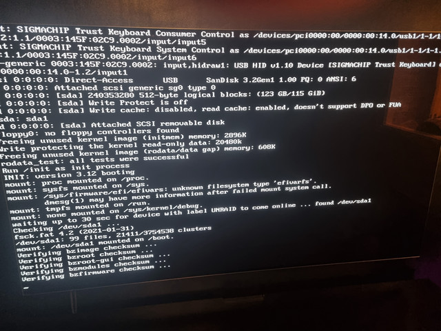

So the problem is boot seems unstable, takes maybe 3-4 attempts to get in. Then once I setup Sonarr or SABnzb they were crashing the system completely once a file had finished downloading and Sonarr tried to import the file (it worked a couple of times ok, but most times would reset the system). Apart from docker use, shares all seemed stable.
I thought before I try to sort that I'd try and sort the boot out. This is the message it hangs on; I think the error message can change but this is a common one;
Any help would be appreciated. I did read reviews saying people were using this system flawlessly with Unraid so not sure what I'm dong wrong, but I'm a little out my depth. I did try formatting usb and creating a new USB but that didn't solve the problem

I have two F8 Plus NAS devices running unRAID 7.0.0 with Samsung USB sticks.  I did encounter issues after upgrading with third party memory (Crucial) causing NVMe disks to drop out when under heavy load.  I then switched back to the TerraMaster branded memory originally provided with the devices and have had no issues since.
I also had to disable secure boot, disable VT-d and disable TOS Boot First to get unRAID to correctly load.
Fixed it today! Hopefully the 20 or so resets wouldn't of damaged anything, It all looks great and boots every time.
Solution; In the bios make the following changes;
Security → Secure Boot → Secure Boot → Disabled
Boot → TOS Boot First → Disabled
VT-d > Disabled.
Thank you @PPH we posted at the same time. It should help anyone else who gets this NAS.
