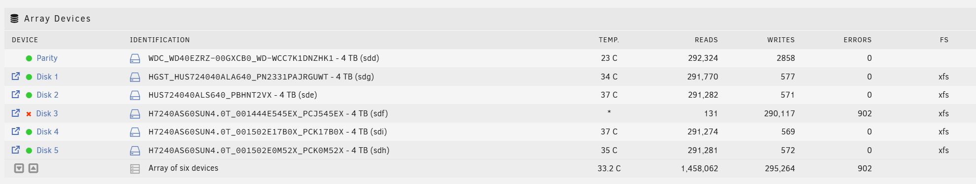

Drive 3 repeatedly disables based on error count. It is only ever drive 3. All array drives (except Parity) are SAS drives running off a 2 port LSI SAS controller, using the miniSAS 8087 to 4x SAS/SATA power combined connector (SATA power plugs into the back)
Steps taken so far:
Replaced the drive with a known good unit
Changed power connection for SAS drive
Changed SAS connection for SAS drive
Changed port on controller for the 8087 end
Changed cable to SAS drives from controller (bought brand new one)
Replaced power supply for system (was using a Gamemax now using Corsair RM Modular - all drives are directly connected with no splitters)
Even with all those changes it's still only ever drive 3 that disables.
I'm stumped and going to resort moving the emulated content to the other drives and cutting down to 4 array drives in the mean time.

It's not logged as a disk problem, but looks like you already replaced everything, I would try once more to swap cables/slot with a different disk, and see where the issue follows.
I've now tested with another known good drive with the same result. All 3 drives have been tested again under Windows and Linux with no issues and as above not showing as a disk problem.
It's always disk 3 regardless of which physical SAS connection or SATA power connection is used.
Currently it's looking like I may have to move to one of the above alternatives and lose the array functionality which isn't something I want to do.

OK, I was under the impression it was error count based as that's the point that this one is being disabled, but that doesn't explain why Unraid is disabling good drives only when on a specific chosen point in the array. When not in the array they all pass preclear, they have been tested in other machines. This happens on all 8 SAS connectors which work fine for other drives, same with SATA power connectors.
Does Unraid get upset at other reasons for a write fail even if a drive is fine? like bad data on a good drive being copied (not that I've done that while this has been going on).
Could a bad parity write/update cause this (Parity was fine and tested every month until the first failure showed up)?
