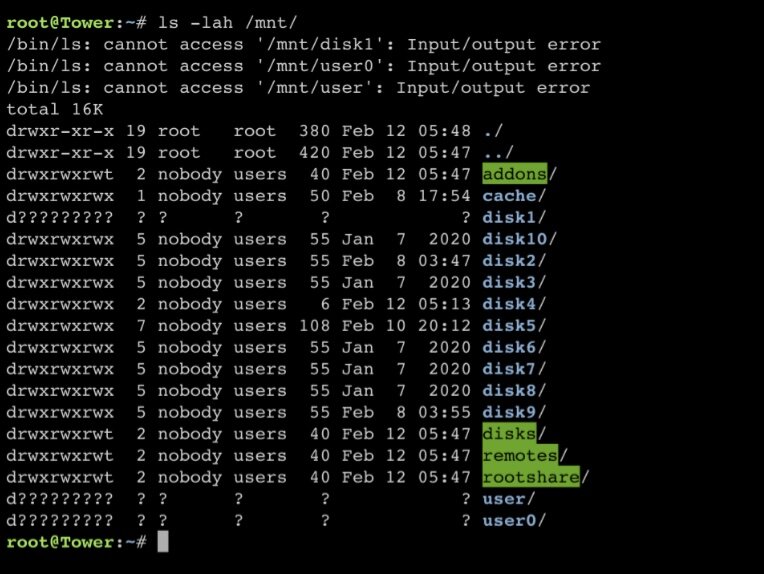

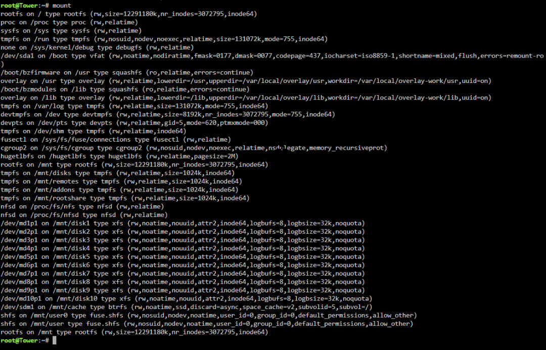

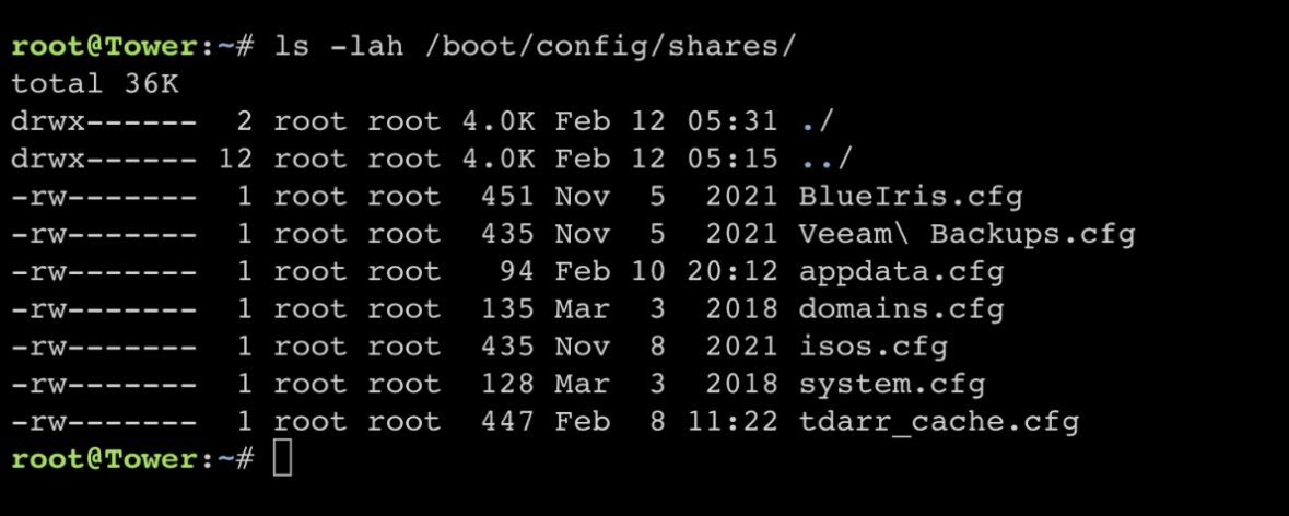

Hello,
I have been going on for 4 days now trying to repair this issue. It all started when I got a notification that a drive had an error. I matched the drive with the Serial number and pulled it. However, the parity failed also. So I got back to the point where I installed a new parity, rebuilt it, and then did a New Config and put in a new drive to replace the errored drive. Everything was rebuilding perfectly, and I was finally on the right track. Until I reached the point where none of the shared folders showed anywhere, I did an SSH, and I can see they exist. They are just not 'visible' or 'appropriately mounted. Another drive had corrupted information, so I mounted it as a read-only and moved the files to another drive. I was planning on swapping it. But when I tried to stop the array. It took 2 hours with zero progress. I rebooted to see if that would help, and now it is doing a parity check. The parity check has corrected 514 errors so far, but now the drives all say they are 128 GB in size and have only 15% use for each. I also tried to use SSH to see if there is anything on it, but it doesn't return anything even though they are correctly mounted. I need serious help, please.

There's filesystem corruption on the emulated disk1:
Feb 13 21:51:05 Tower kernel: XFS (md1p1): Internal error ir.loaded != ifp->if_nextents at line 1203 of file fs/xfs/libxfs/xfs_bmap.c.  Caller xfs_iread_extents+0xb2/0x125
Also, seeing a lot of ATA errors with multiple disks, they are from the disks connect to the Marvell controller with a port multiplier, both things are not recommended, recommend replacing it with a recommended model, then check filesystem on the emulated disk1.
