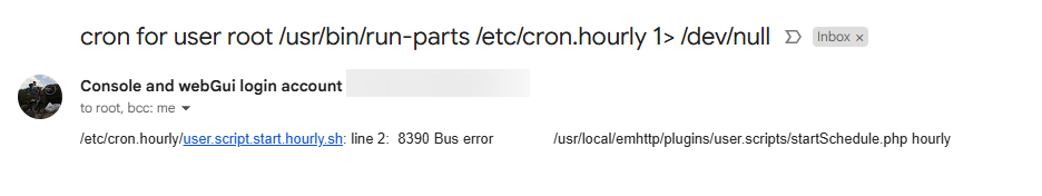

I recently have been getting some cron error reports to me email,
and today my server web panel is showing as 500 internal server error.
I'm reluctant to restart the server as I'm not sure if it will reboot?
not sure how I could get diagnostics...
Any help greatly appreciated

My SMB shares have gone offline, but cameras are still running on blueiris and frigate. Unable to watch clips back on blueiris that are stored on the array, but can watch frigate back as they are stored on a separate pool.
This was also emailed to me at 17:47

syslog.txtI see the errors but they mean nothing to me!!
I've created a new USB Boot drive, and copied my config across. Its booted fine, and seems to be working OK.
Is there anything I should check before I consider myself in the clear?
Those errors suggest a flash drive issue, so you should be fine now.

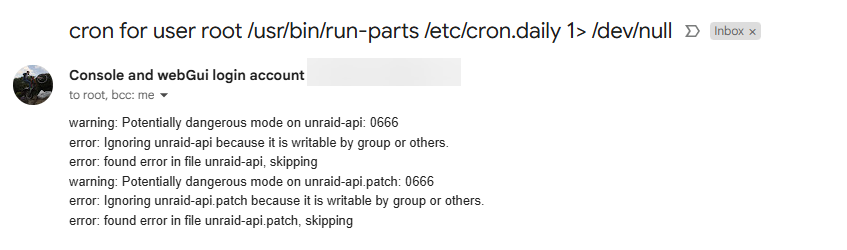

Seems to be running fine, but I'm getting emails every now and then with this...
vault-diagnostics-20250223-1450.zip
Update the Connect plugin to latest and it should resolve that.
