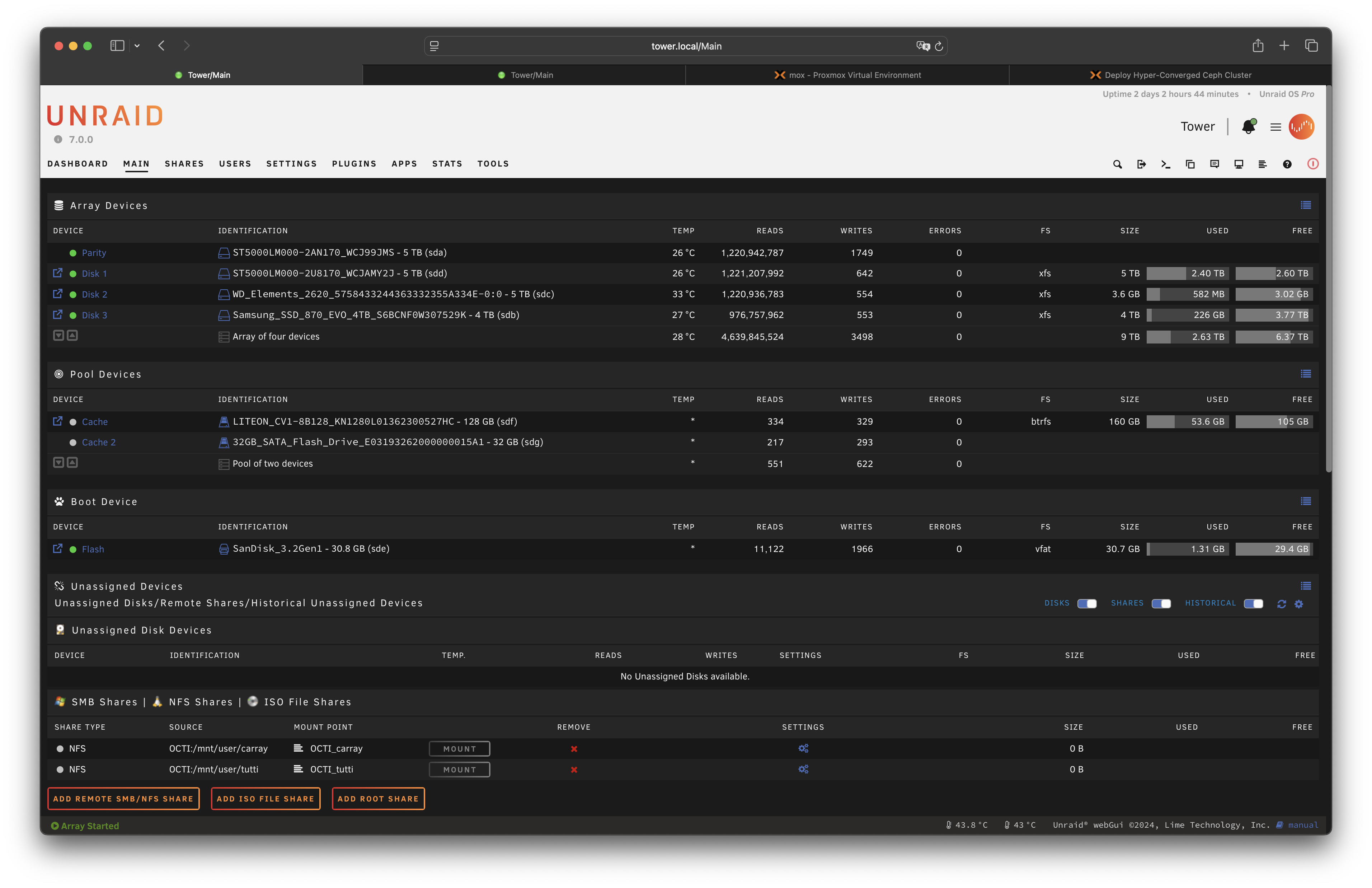

  • I wanted to shrink my array, which consisted of:
    • Parity: 5 TB HDD
    • Disk 1: 5 TB HDD
    • Disk 2: 5 TB HDD --> this is the one I wanted to remove
  • Then I wanted to add a 4 TB SSD into the array.
  • There's a cache pool
  • I'm using Unraid 7.0.0
I tried following method #2 as laid out in Spaceinvader One's video and used the unBalanced plugin to move the data off Disk 2.
The idea was to shrink the array without losing parity.
In another step, I added the 4 TB SSD to the array and moved a share from Disk 1 to it (which was probably a bad idea).
Then I cleared Disk 2 and tried stopping the array, as suggested in the video. This is when things got ugly. The array refused to stop because Disk 2 couldn't be unmounted. The log claimed that it wasn't mounted - so it couldn't be unmounted. Basically, my server was stuck in a loop.

Well, I discovered a slight oversight regarding the network issues: The switch power cable had become unplugged. 🙈 Duh.
So the good news is, I can access my server again. I now have installed a more recent backup on my flash drive and booted up again. Strangely enough, Unraid has asked me to set a new root password. After that, I could access my server. Basically, I'm almost back on square one now:
- My server has its old name
- Bloody Disk 2 is still there without any data on it
- The 4 TB SSD resides in the array as Disk 3
I guess I'll just backup my flash drive now, remove Disk 2 and rebuild parity. I'm not willing to risk another odyssey like this, even though my array won't be parity protected during the rebuild.
That is always my recommendation for shrinking the array. Simpler so less opportunity for problems.
