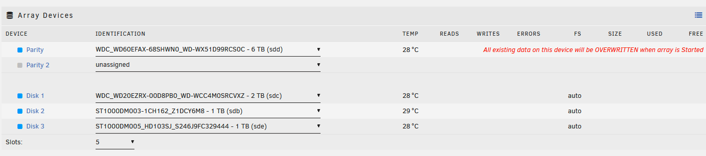

I've done some searching around the internet as to how I can create a new array without wiping the files from my drives, but I haven't been able to find a single definitive answer: It's not clear to me if I can just reassign all drives to the array and start it up, or if I need to use the "New Config" tool, or...something else.
If I tentatively assign drives in the UI (but don't start the array), I get this message:

Assuming you had parity installed, the 6TB drives must be it, so if all previous disks are assigned, in this case data device order is not important, just check "parity is already valid" and start the array, if any of the data disks don't mount post the diags, and if they all do it's still good to run a parity check,
Thanks! This worked perfectly.
