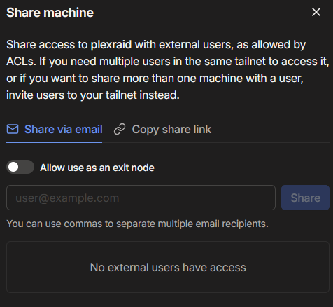

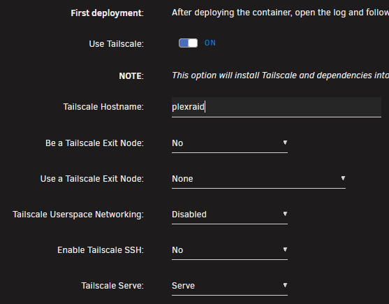

Toggle the tailscale button on the plex docker container page, set it to SERVE mode, open console, click the link to authenticate, it now should show up on your tailscale admin dashboard, then click the share button next to it like below, and you're done.
image.png.a8e5354a54866b1048212a730a905756.pngimage.png.e46d6cd4885defb5f36531057b057883.pngimage.png.8cb7c6a23db83df1ed13f436baec94c1.png
