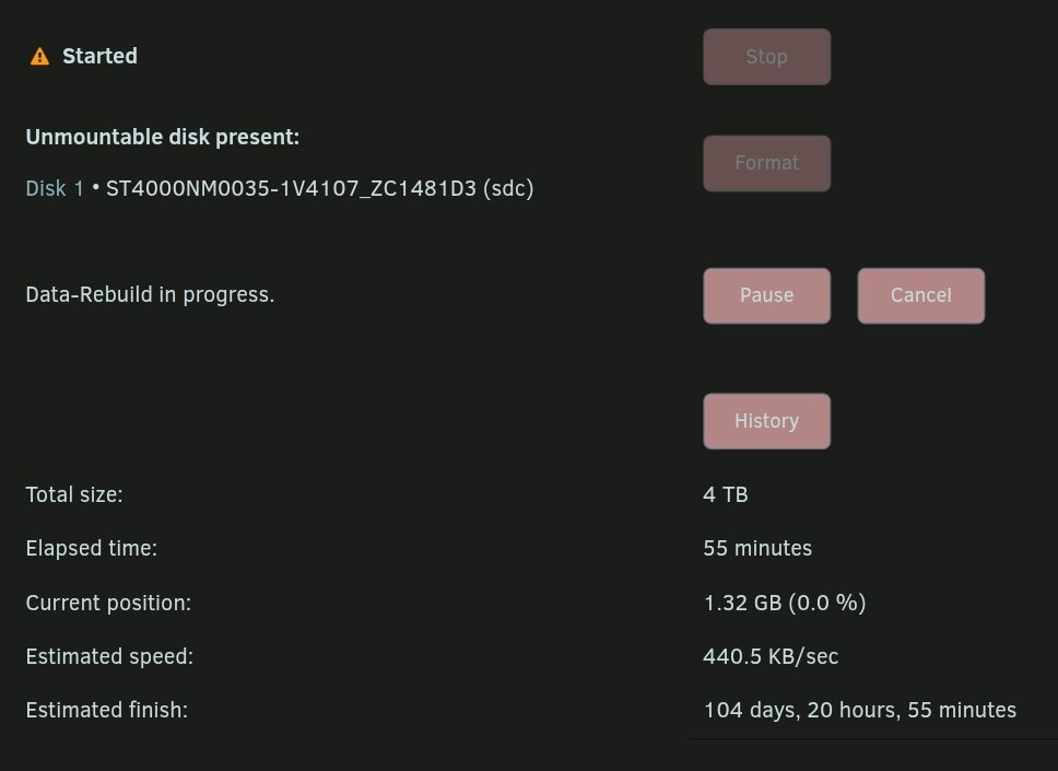

To my surprise the array was started and all services on the run about 50mins ago.
However on the main page, it says data-rebuild in progress while a format button appears for the old 4t disk at the same time, says needs formatting. Please see the following screenshot also showing the estimated time of over 100days..
The gui shows writes into this disk, but how is it unmounted at the same time?

Do you remember if disk1 was unmountable before you started all this?
DO NOT FORMAT.
We will have to check filesystem after rebuild.

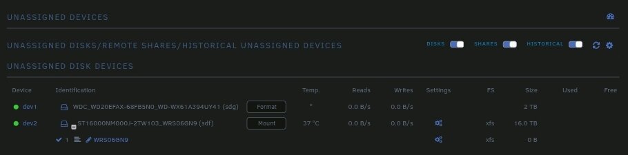

Post a screenshot of Main - Unassigned Devices
Screenshot attached.
Looks like sdg is also unmountable.
What is sdf?
Sdg is the 6th new disk, prepared for expansion.
