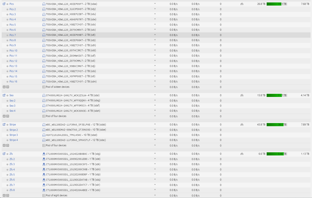

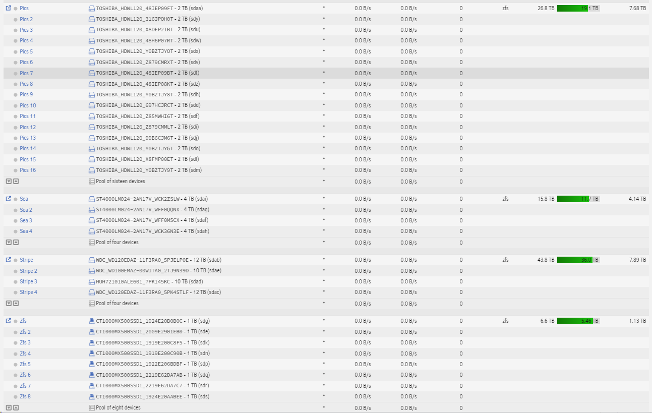

1 hour ago, itimpi said:
I guess the question (which I am not sure of the answer to) is whether ZFS pools allow disks to spun down in the first place?
They do, as long as the pools are not used:
