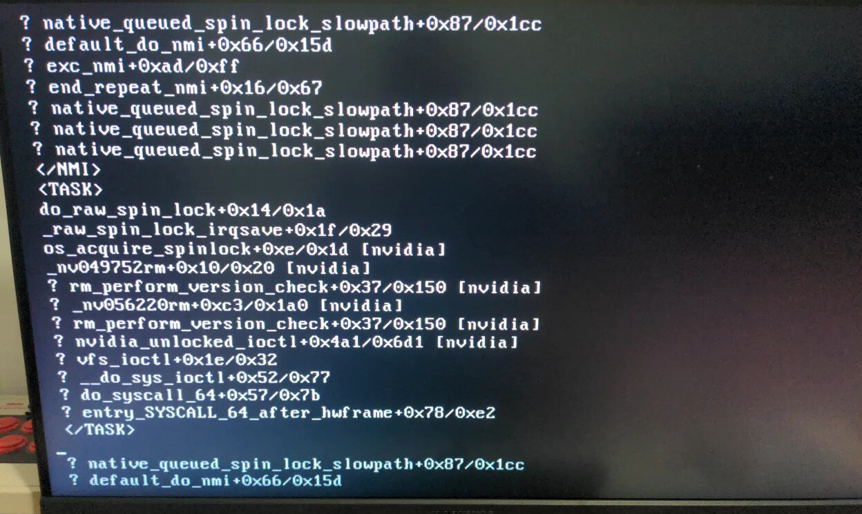

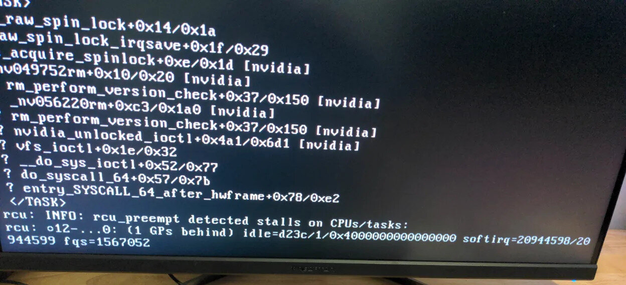

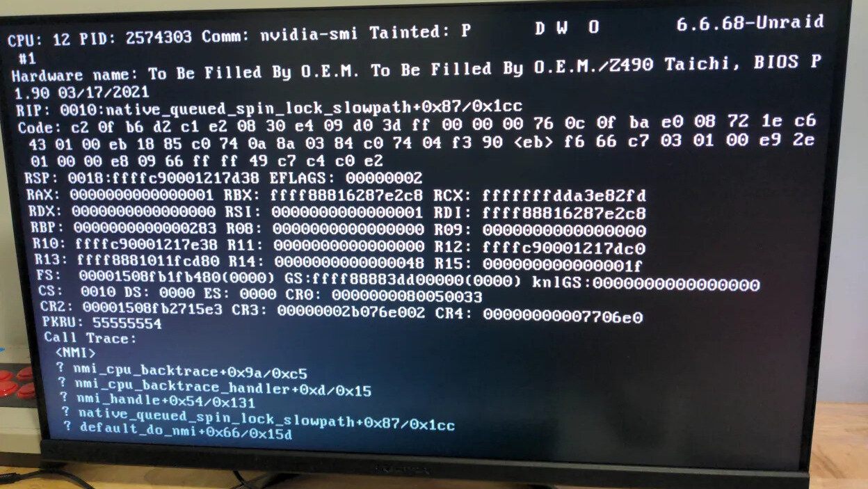

In the meanwhile @JorgeB, I also wanted to add some pictures that I took while it was unresponsive maybe something relevant can be seen on there?
Thanks again for your help.
According to a knowledgeable person around me:
seems like you have a random syscall that stalls because the nvidia driver attempts to do something and just gets stuck
you should blacklist the module to test it out
(and from what I see, looks like the console is in textmode already - not even framebuffer. so what is the driver even doing?)
Those look Nvidia related, try without the Nvidia driver
