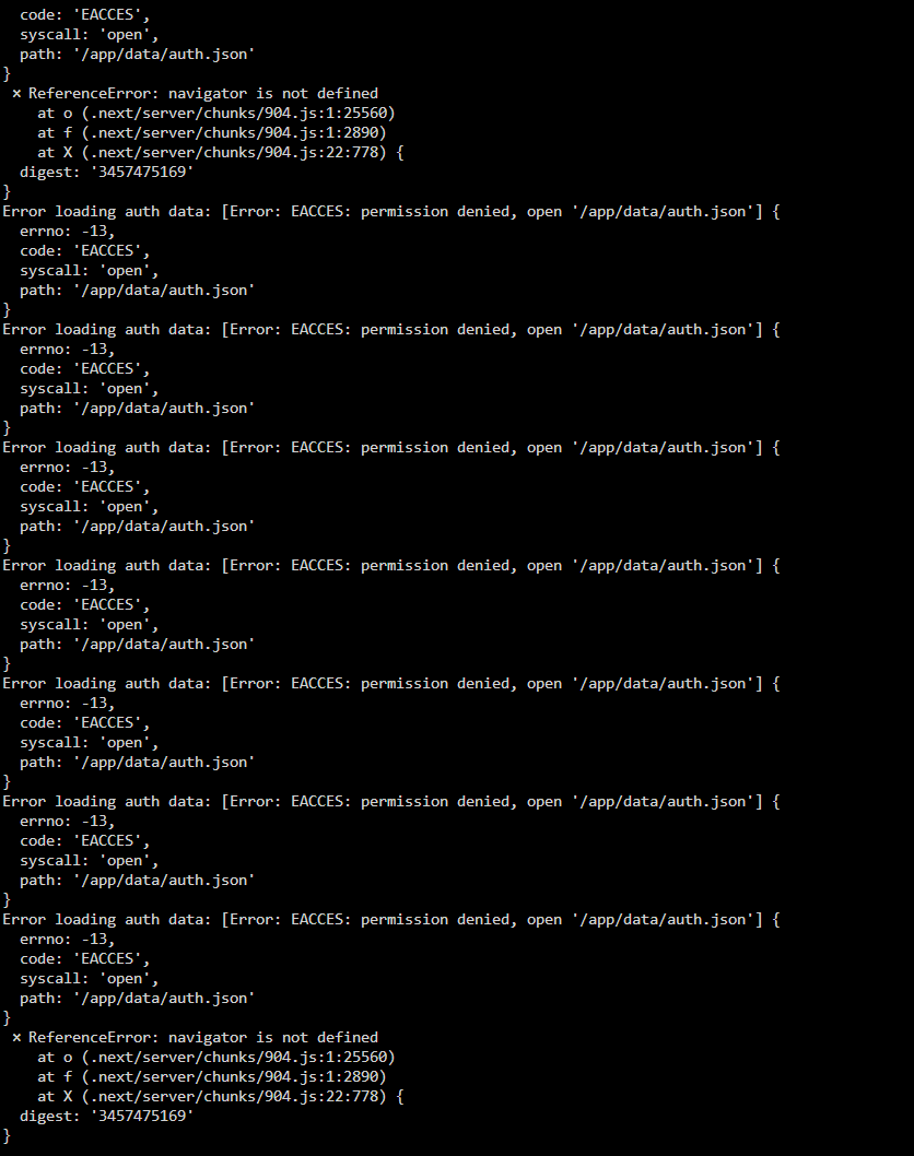

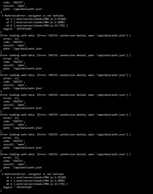

Yesterday everything still worked fine, but today I can't login when I click on admin, it always says guest at the top right. My logs look like this: And how can I add new users, I haven't found a button for it?
Its wierd cause I set a pw to the Auth_secret
but am still in Guest account and when I want to add coins then  image.png.52e050a27e917c6afc0e73ef52f90c01.png
