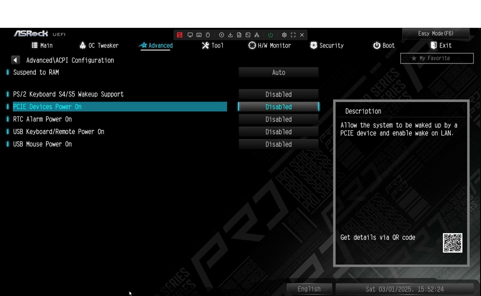

I have an AsRock Z790 Pro Rs ATX DDR5 (no WiFi) motherboard with an i9-12900k, and made sure that under Advanced > ACPI Configuration, PCIE Devices Power On was set to disabled, and I'm at a loss as to why it's staying powered.UnraidBIOS-WOLdisabled.thumb.JPG.68203862d9b8c30891b5a35e9fb86c50.JPG

Safe mode or normal mode, the result is the same. The only "fix" seems to be enabling "Deep Sleep in S5" in the Chipset Configuration in the BIOS. I am absolutely certain that the server shut down perfectly to begin with when the Deep Sleep setting was "disabled" (which it is by default), and this behaviour started after enabling Wake on Lan for eth 1.

It should be normal, the setting won't permanently store in NIC's firmware. We don't need permanently, if mobo BIOS disable WOL then it won't wakeup even NIC WOL was enable, this shouldn't affect shutdown or anything.
I use WOL always and apply in different platform in Iongtime. I think problem need fix by new BIOS release.
