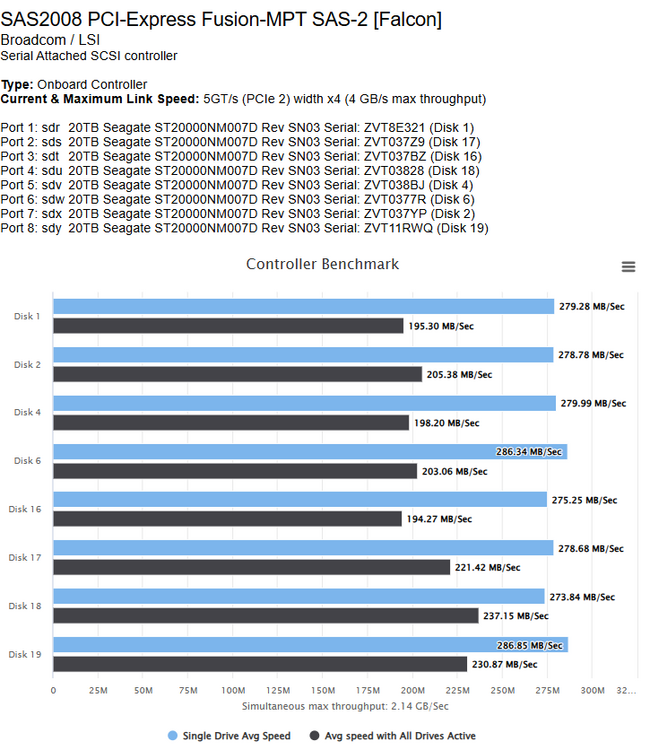

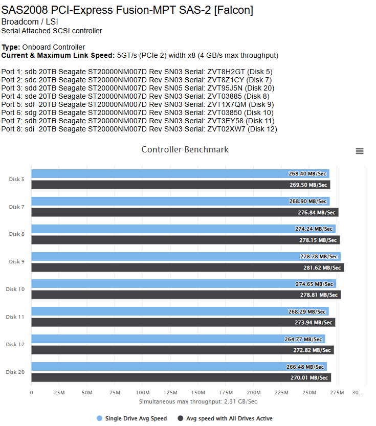

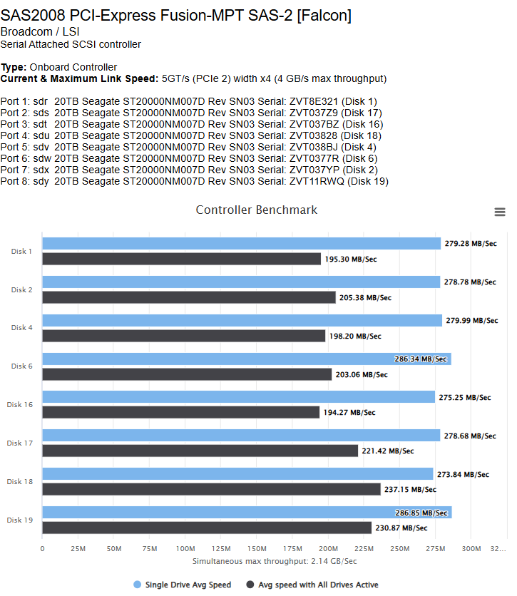

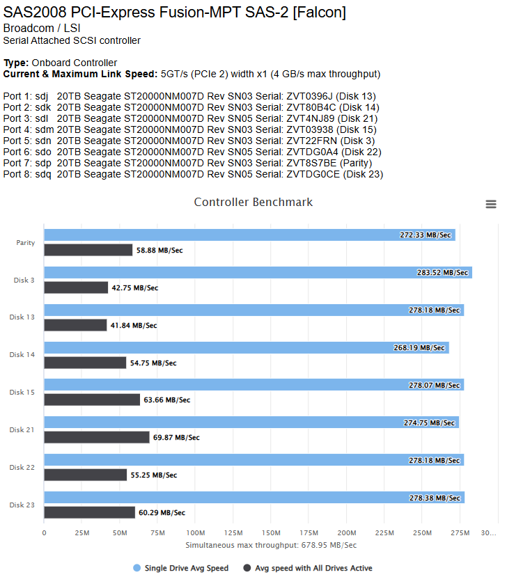

Running diskspeed docker, it reports that one controller is running slow:
Controller 1
Current & Maximum Link Speed: 5GT/s (PCIe 2) width x8 (4 GB/s max throughput)
Controller 2
Current & Maximum Link Speed: 5GT/s (PCIe 2) width x1 (4 GB/s max throughput)
Controller 3
Current & Maximum Link Speed: 5GT/s (PCIe 2) width x4 (4 GB/s max throughput)

Any ideas as to what could be causing the  x1 width on controller 2? faulty controller? or is something amiss on the motherboard

Controller 1 speed results
Controller 2 speed results
Controller 3 speed results
It's the board, not enough lanes:
PCI_E3 & PCI_E4 (from Z690 chipset)
Supports up to PCIe 3.0 x4 & 3.0 x1
ok, that is staring me in the face now. whoops!
thank you for spotting that.
so that doesn't leave lots of options (moving some drives to SATS might give some bandwidth, but it looks like I will need to consider a 16-port SAS controller (if enough capacity is provided by PCI_E1 slot), or change platform(Threadripper?)
