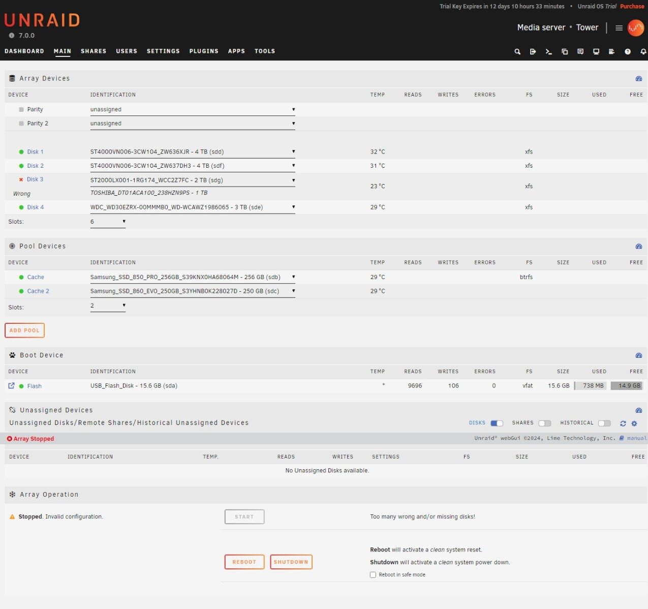

Started with new (1) 8TB Parity drive and (2) 4TB Data drives.  I installed then removed the parity drive so that I can load data from a big pile of old drives. My plan was to move data off the old drives, then add them to expand the array. Then build the parity drive and setup cache pool once I had the array loaded.
However, I ran into a cascade of problems after adding a drive that came up with a bunch of CRC errors (I didn't properly preclear it).
It doesn't have any data on it yet. But when I try to swap it with a larger drive. I get a "Wrong" message in the drive slot and "Invalid configuration" in Array Operation.
Most of the info I've seen about drive swaps rely on parity rebuild of the new drive. But there is no parity available and nothing to rebuild in this case.
I know about the array reset option. But I'm not sure if I do that I'll loose the new data that's been added to the two 4TB drives?

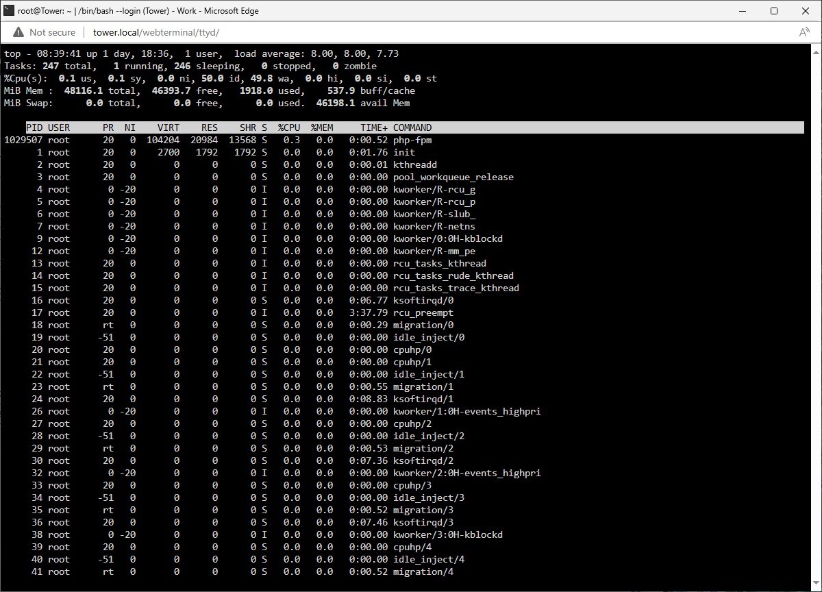

While trying to deal with the drive issue above I'm now seeing stability problems - not responsive to shut down/reboot command via UI or console. In an attempt to force a clean shutdown I tried to do a single press of the power button but accidentally hit the reset button, causing a dirty reboot. The system came back, all drives present. However after a bit I'm back to not responsive shutdown again and this time the local console is weird... delayed keyboard response, repeating Unraid version/IP info.... before I can get to a login prompt.  CTRL+C did not clear the issue.
The UI still works and I can get into the web console.
I tried to collect the diag info but the process stalled (bouncing green dots) after the following line ...
  smartctl -x '/dev/sde' 2>/dev/null|todos >'/tower-diagnostics-20250303-1202/smart/WDC_WD30EZRX-00MMMB0_WD-WCAWZ1986065-20250303-1202 disk4 (sde).txt'

Solved by JorgeB
Tools - New config.
1 hour ago, JorgeB said:
Tools - New config.
Will the 4TB drives be readded with data intact?
@JorgeB Thank you. That worked for one piece of the post.
This UI process leaves a bit to be desired. It would be awesome if there was a simple button next to a drive slot in Main that would allow you to accomplish the same thing without the feeling of a scorched earth procedure.
I get the same feeling when I click the format box which feels like your preforming a global format on the whole array vs the drive marked as unformatted. It would add confidence if there was some level of drive association with what seems like a global procedure. Again a format button or tickbox next to the unformatted drive would be awesome.
The devices that will be formatted are listed on the left of the format button.
Is there a way to force remove a drive from the array... given above?
Not sure what you mean, without parity, to remove a drive you need to do a new config, like mentioned.
