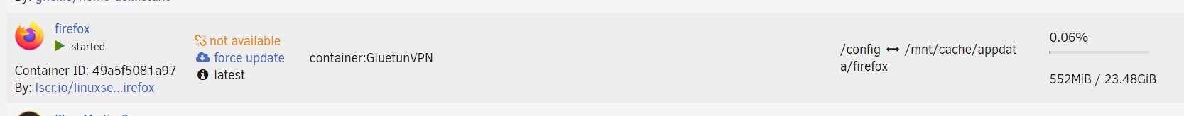

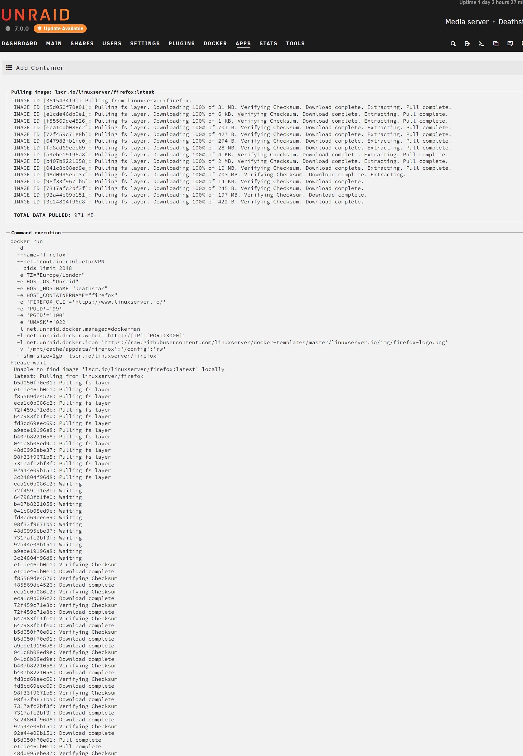

I tried installing Firefox, which has a 703mb file as part of the installation.
The screenshot shows the issue and the subsequent when the installation began, which I assume is prematurely.

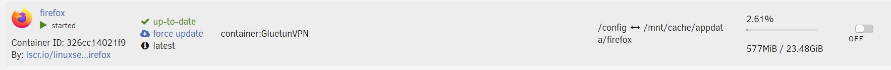

Once the install is finished I get the version Not Available issueScreenshot_5-3-2025_182144_192_168.0_210.thumb.jpeg.ea1b11fb5d6bfd9df1cae297d9866ea5.jpeg
Force an update and ...
Screenshot_5-3-2025_182224_192_168.0_210.thumb.jpeg.e6cd55a7a7c6e600b836edc3d9c3c634.jpeg
Can you uninstall then reinstall but don't switch the network to container:GluetunVPN. Leave it at the default bridge.  If that fixes, then the issue is somewhere in Gluetun

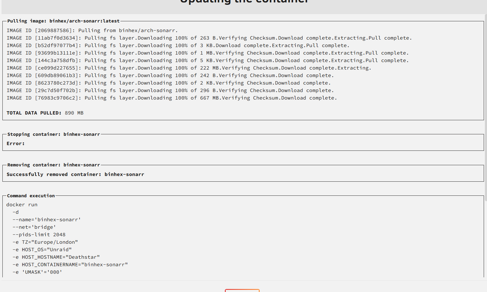

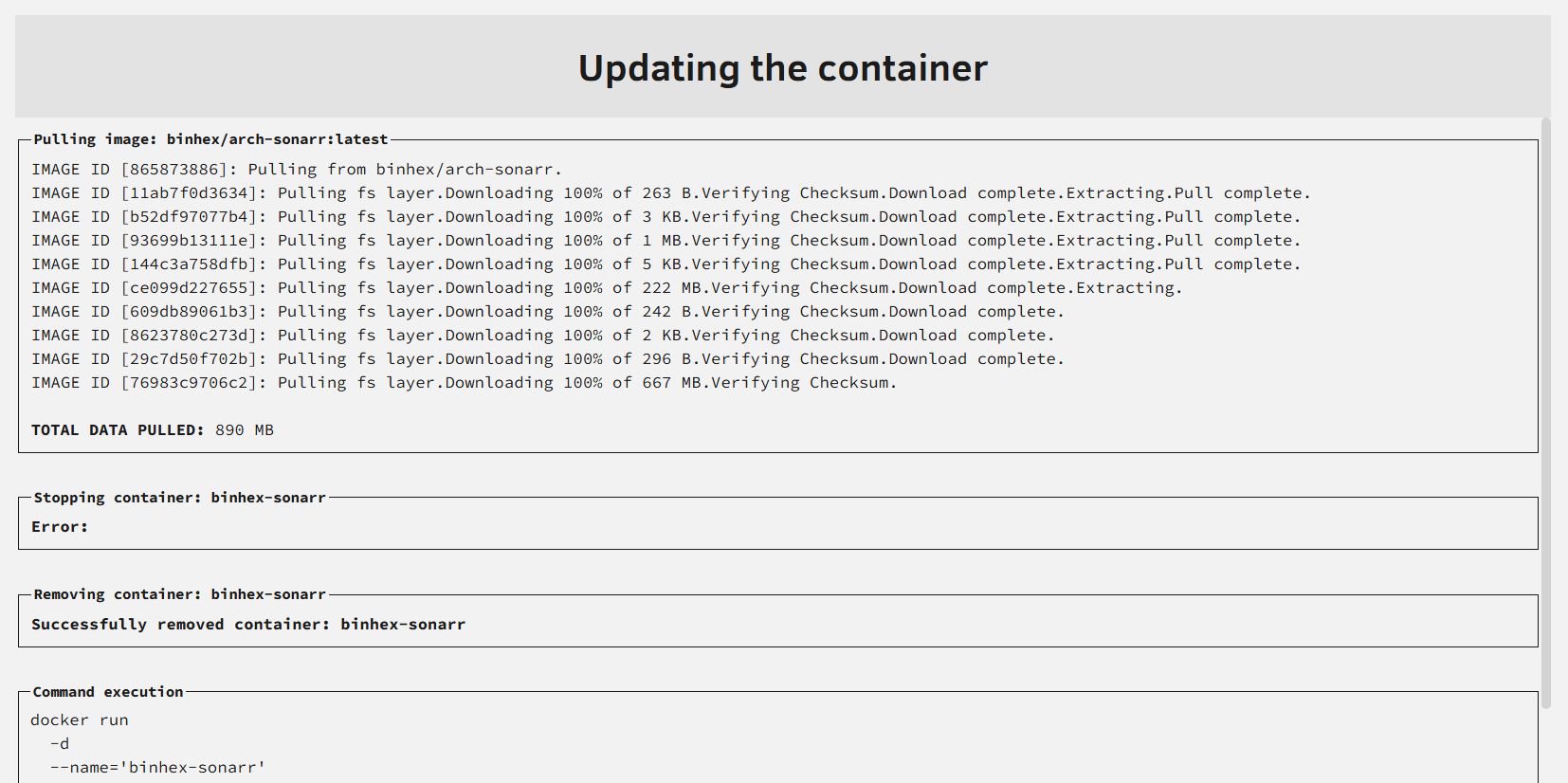

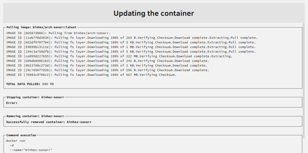

So I did some more digging as more docket updates arrived.
Plex - Updated without any error. The largest image in the update was 103mb - Extracting took 17 seconds.
Home Assistant - Largest Imahe was 366mb - Extraction rn for 84 seconds before the update started prematurely.
Binhex Sonarr - Largest image was 667mb, but image being extracted was 222Mb. It ran for 83 seconds before the update started prematurely.
Everything is downloading; it is the extraction that is not complete before the update starts.
Any help is appreciated. I'm out of ideas, other than wipe everything and go back to the start, which I've all but done as I've recreated the docker environment. Next would be a new Unraid installation.

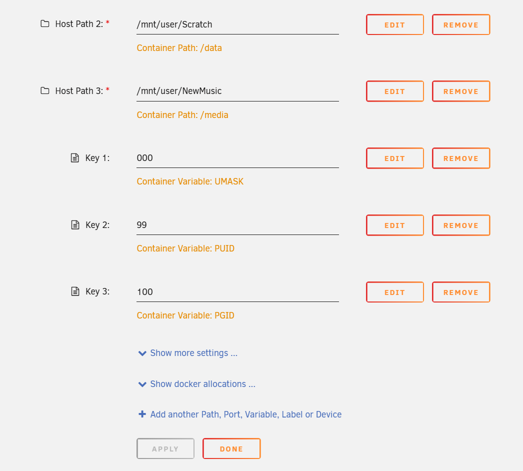

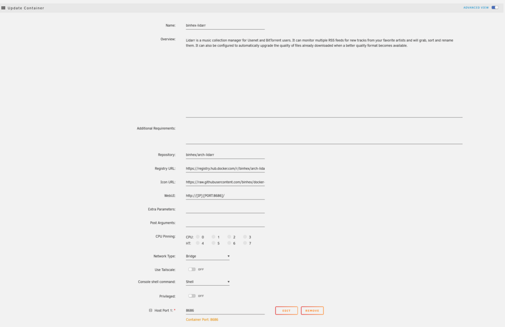

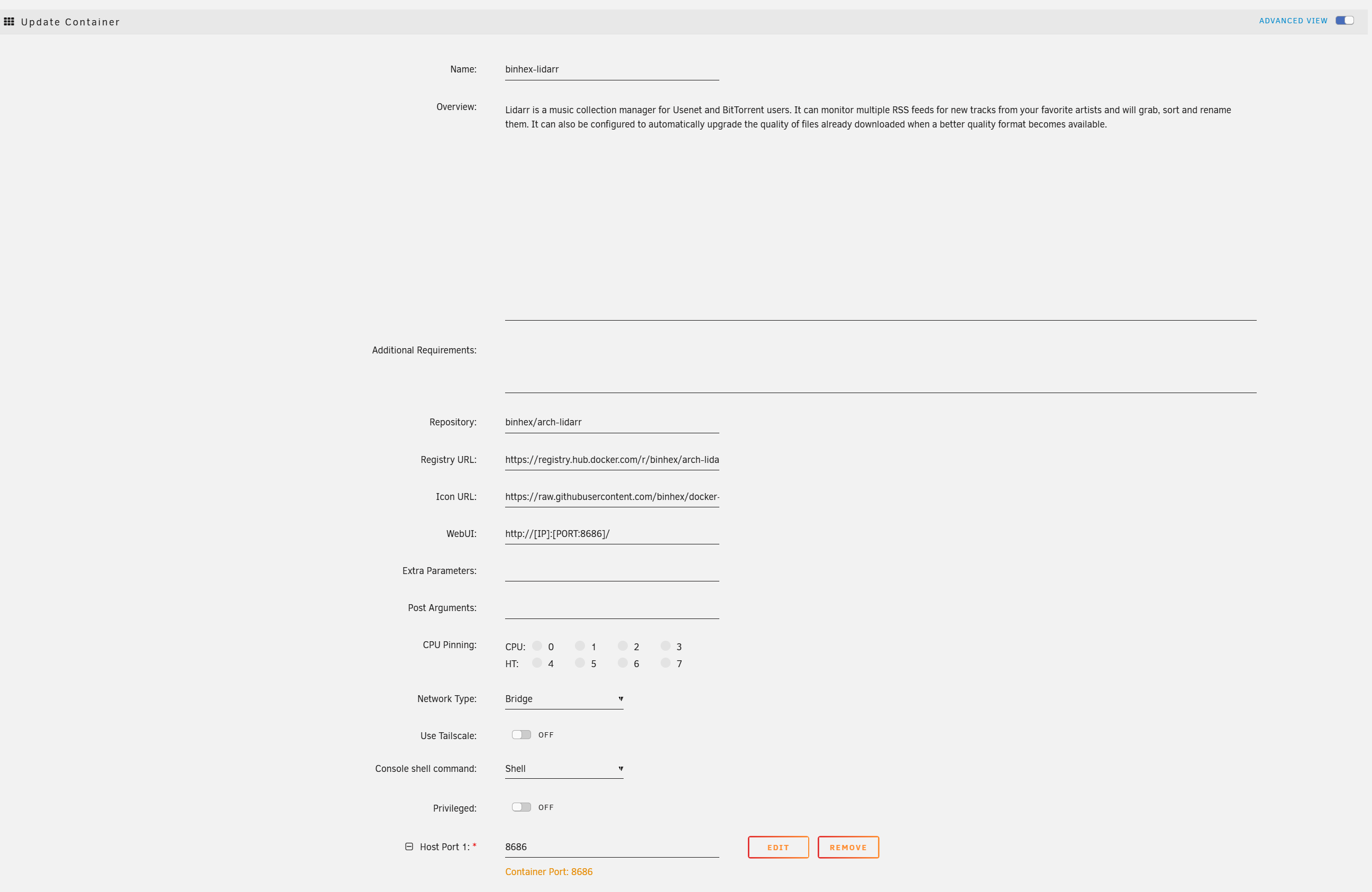

To what repository is the container set in the Docker template?
Do you have added any extra parameters to the container, please post a screenshot from your template with Advanced View enabled.
Hello Ich777,
This isn't limited to one container it is all of them. Lidarr is below. The pull works fine; the extraction starts, but the command to run the update begins - for some reason - before the extract is complete.
