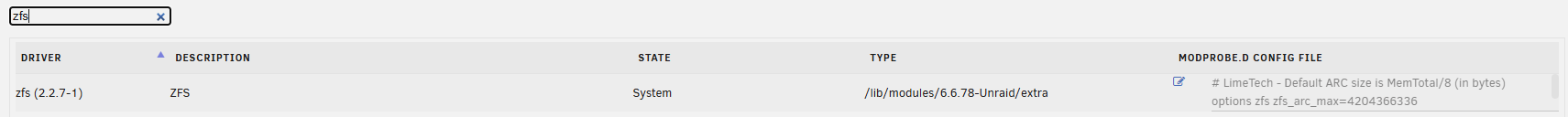

You may need to lower zfs arc memory.
Unraid web UI > system drivers > zfs
you may need to lower the number to decrease zfs arch cahce and ram usage...

By default it only uses 1/8th of system RAM
