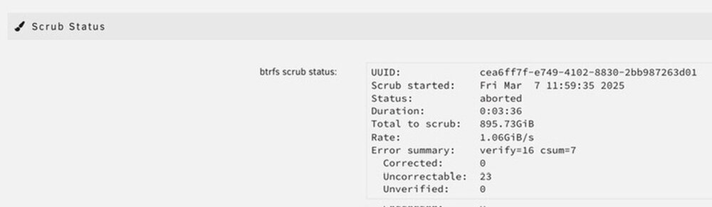

I've attempted to run the scrub command, however it seems to be aborting and not completing it's run. 4B4EF62E-7145-46C5-96FF-11061C665ADE_4_5005_c.thumb.jpeg.3e811e1218caf12eb00bc4a4ed5e1ca0.jpeg
If the scrub is aborting there are other issues, I would recommend backing up what you can from the pool and then reformat

Took me some time to get back around to this, and I definitely found a couple of corrupted files while attempting to backup the drive, but the reformat cleared the scrub errors. Thanks for the help!
