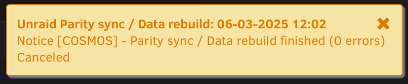

The parity process runs for hours and almost completes, but then the server suddenly becomes unreachable. When I restart and log back in, it shows that the parity was canceled just 11 seconds after starting, which doesn’t make sense given how long it actually runs.
I’ve already run a RAM check, and everything seems fine. There is a UDMA CRC error on the parity drive, but it’s not increasing.Screenshot2025-03-06at12_02_44PM.png.ca982f2b5f10732005932213e6f382e5.png

The parity sync completed successfully when I used a different drive as parity. Initially, I was using a 6TB Seagate drive for parity along with two 4TB WD drives for data, but the parity sync kept failing. After posting about the issue, I decided to remove the 6TB drive and use one of the 4TB drives as parity instead. This time, the sync completed without any errors.

It tried it again with the 6TB drive as parity - it didn't work.

I got the 6TB drive replaced and it is working fine now. The issue now is that the serv er is getting disconnected automatically. syslog
