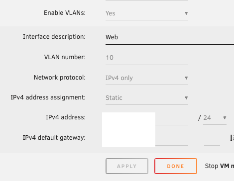

I can not get containers in one LAN to communicate with containers in another VLAN.
More specificly get a Wordpress container in a vlan2 to connect to mariadb in vlan1. These two containers connects fine when in vlan1. Testing with another container in vlan2 to connect to container in vlan1 also fails. Connections from a device in vlan3 connects to vlan1. Unifi UDM SE network, no blocking policies there. This point to some network issues on the server. Docker custum network = ipvlan.

That can´t be correct in this case. I tested communication between VLANs, it worked, but not when going from a container. I was able to manually include a route, then it was partly working. I expect a routing issue with ipvlan.

That could be true if you apply routing rule in Unraid, so Unraid would acting router to route traffic between VLAN. ( I am not sure about that )
But I perform this at router side and I never add routing in Unraid.
