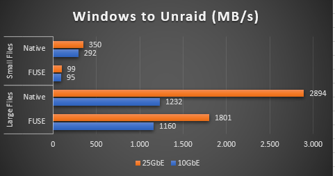

March 8, 20251 yr Hi, I have an unraid setup with 10GbE and a 970 Evo cache drive. Writes to this machine max out around 650MB/s. iPerf shows 950MB/s over the network. But, diskspeed shows average writes to the NVME 970 Evo at 650MB/s, which is my limiting factor. Why is this drive performing so slowly? In a windows machine, it can write at 2.5 GB/s. Are there settings I should change? Edited March 8, 20251 yr by Belgian Genius update

March 17, 20251 yr Community Expert 700MB/s is pretty good, you may get more if you use a disk share (or exclusive share).

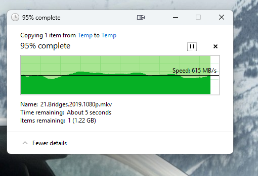

March 18, 20251 yr Community Expert There should be a difference, user share (FUSE) should always be slower vs native, though sometimes not by much, so something else may be interfering: Post a screenshot of the Windows explorer graph during a large transfer, that can help show if the issue is the LAN or the device.
March 23, 20251 yr Author Here's a graph of transferring a 25GB file. It bounces all over the place from a low of 500MB/s to a high of about 800MB/s. By comparison, transfers to my Windows server on the same network are a straight line around 980MB/s.
March 24, 20251 yr Community Expert Since the initial transfer speed is already low, it usually means the LAN, or source PC, is the issue, if it were a device issue, it would start at full speed while it's being cached to RAM, and then slow down to actual device speed.

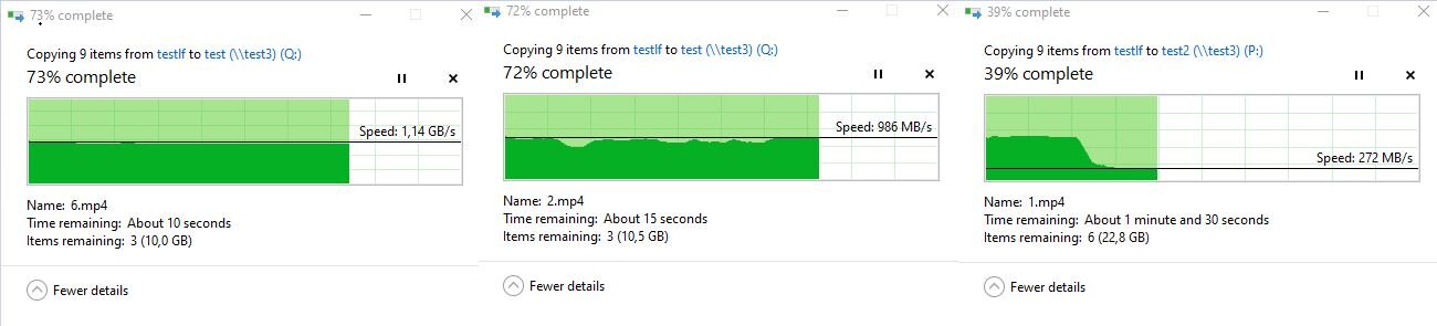

March 26, 20251 yr Community Expert Here are some examples to show how the Windows transfer graph can help identify where the issue is. 1st one shows optimal speed with 10GbE, 2nd one shows a network issue limiting the transfer, in this case caused by using a very low MTU value, last one shows a device limited transfer, it starts at 1.15GB/s while it's caching to RAM, but then it's limited by the device actual sustained write speed.
