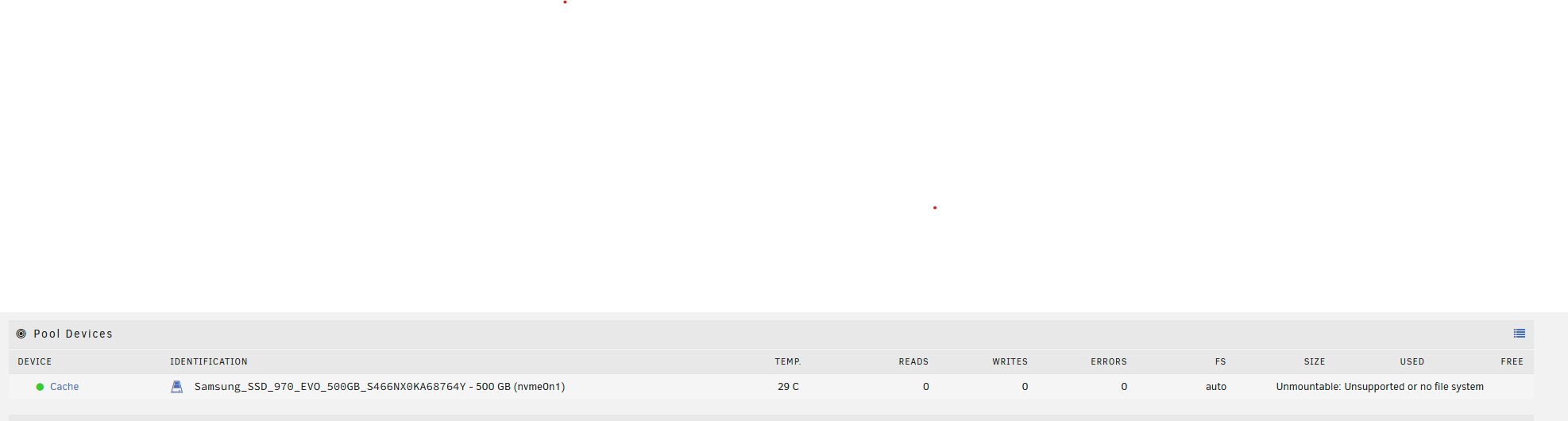

  7. Tried blkdiscard /dev/nvme0n1 -f Still do dice. Same unmountable drive. What gives??
