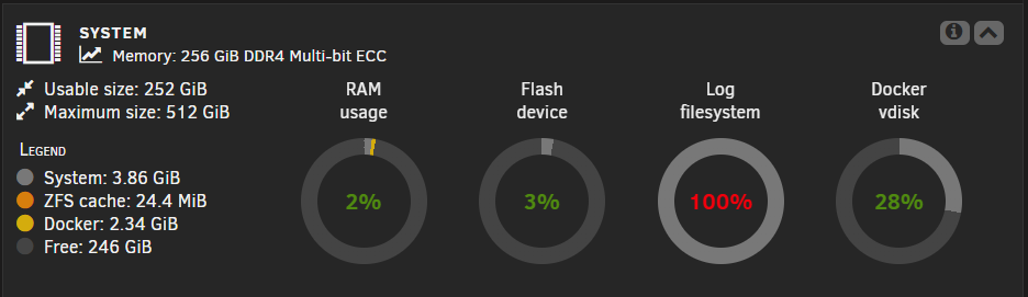

Log file system full or near full everyday
Hi, The log file system is close or full everyday I'm not using the mover logging so i am stumped. I've only been using unraid for a short time and do not have a good knowledge of Linux. so i may not be able to understand any help unless  it is in the simplest of forms, sorry.
Thank you in advance

Hi and thank you for the prompt response
unfortunately this really means nothing to me, i understand its a hardware error? is that what you are seeing?
the replies i am reading to this post are unfortunately confusing and i am not sure where to go from here? Can you explain in simple terms my resolution ?
Thank you

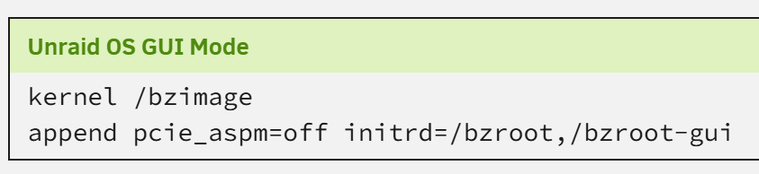

Go to MAIN - Boot Device - flash - Syslinux Configuration and edit the append line for the selected boot option
Thank you that was extremely helpful
I appreciate you taking the time to explain
I have added the lines and shall reboot after my current task is complete
Looks like it has fixed the issue Thank you
