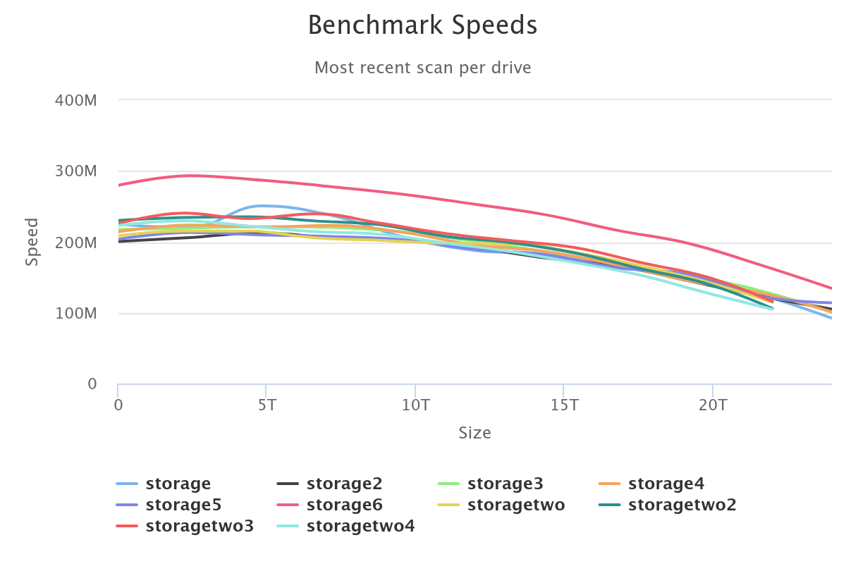

When accessing certain files, I noticed a significant drop in response speed. After running a speed test, I discovered that bandwidth was being capped on the following drives:
storagetwo (sdc)
storagetwo2 (sdd)
storage3 (sdh)
This limitation is affecting performance. Any insights on how to resolve this?
beanserver-diagnostics-20250309-2140.zip
Post the speedtest results.
this?
That looks normal to me, why do you say they are capped?
You do not indicate what speed you are getting that you think means it is 'capped'

When I transfer files, open a RAR file, or access a folder, everything runs slowly. Additionally, when I ran a test, I received a speed cap warning.
Where?
